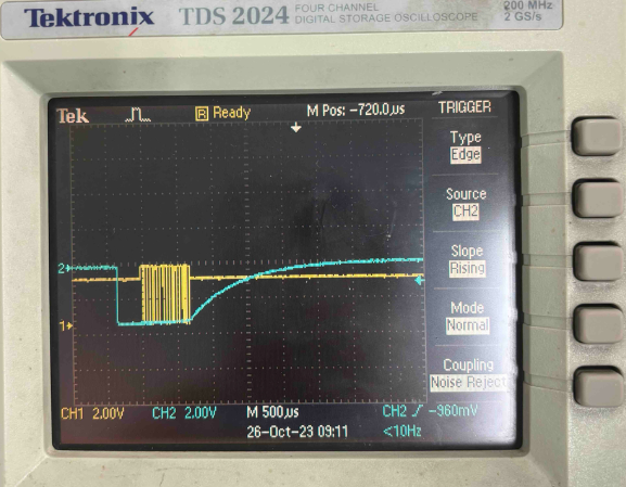

Below is image for ST-Link for nRST and SWCLK when i tried to connect with MCU using STM32Cubeprogrammer.
2 blue channel is nRST, 1 yello channel is SWCLK.
Thank you.

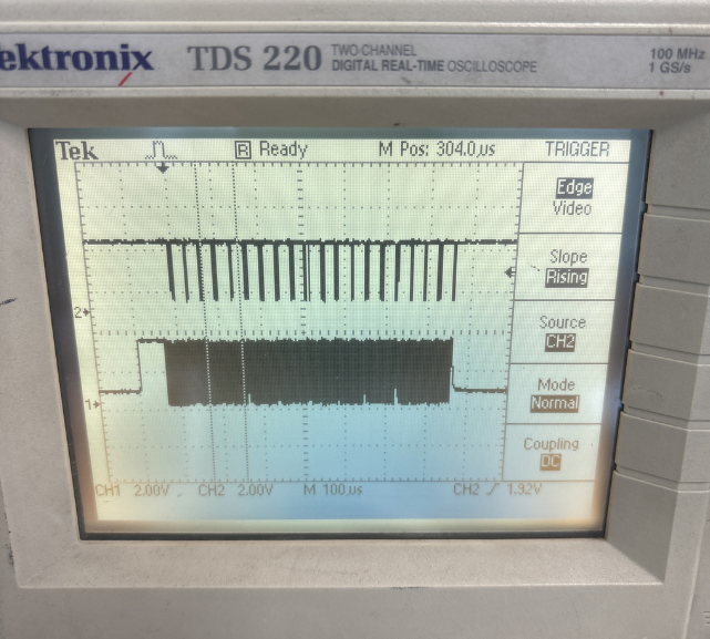

Below is SWDIO, SWCLK waveform when I tried to connect with MCU using STM32CubeProgrammer.
Thank you.

‎2023-10-25 6:43 PM
Blue 2 channel and yellow 1 channel are little bit malfunction to measure the voltage.
Thank you.
BR
‎2023-10-25 9:40 PM - edited ‎2023-10-25 9:42 PM
Is there some issue with the grounding here?
Your diagram here has GND and SWDIO switched. Is the wiring harness correct?
‎2023-10-25 10:44 PM
Hi Tesla,
In first picture, The oscillator is liitle bit malfunction to measure the voltage as you indicated.
However, second picture is good to measure swdio, and swclk waveform.
Thank you.
