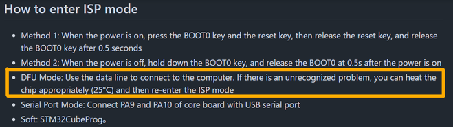

If you bought the WeAct STM32F411CEU6 Black Pill, I'm fairly confident it's a genuine STM32 MCU. You can see their claim here. (I've purchased several of their products and have been happy with them.) They seem aware of the issue, and amusingly, their suggested fix is to heat it up.
The actual problem stems from the UART1 RX pin (PA10) being left floating, which makes it susceptible to random noise. This can cause the MCU to mistakenly enter UART ISP mode on power-up. To prevent this, simply add a pull-up or pull-down resistor (preferably a high-value one) to either 3.3V or GND. This stabilizes the pin and prevents unwanted fluctuations during startup. More details can be found here.
