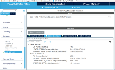

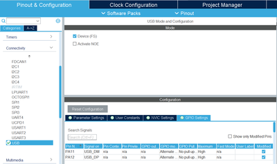

  1. In ioc file, I configured:
    • PA11 as USB_DM and PA12 as USB_DP (image GPIO USB PA11 and PA12).
    • USB mode set to Device FS (image Device FS).
    • USB class set to CDC (image middleware USB device CDC).

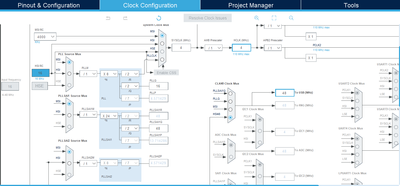

    • Clock source set to HSI48 at 48 MHz (image clock configuration).
  2. The project includes calls to:
    • MX_USB_DEVICE_Init()
    • CDC_Transmit_FS() for data transmission.
  3. Despite this setup, I still get the following error on my Windows 11 laptop:"Unknown USB Device (Device Descriptor Request Failed)"
