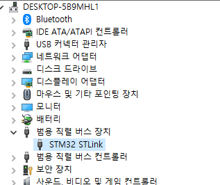

After firmware upgrade for st-link v2, windows computer recognized the st-link as universal serial bus instead of virtual com port. whenever i try to program to MCU, there is error like a "No target device found".
How can I solve it?
Below image is the device manager to be recognized as Universal serial bus. there is no PORT.
Thank advance.

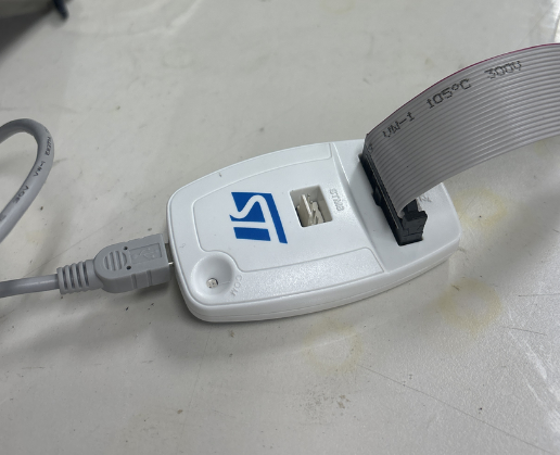

Which software and settings did you use for the firmware upgrade?
Can you please also upload a photo of your ST-LINK/V2 here?

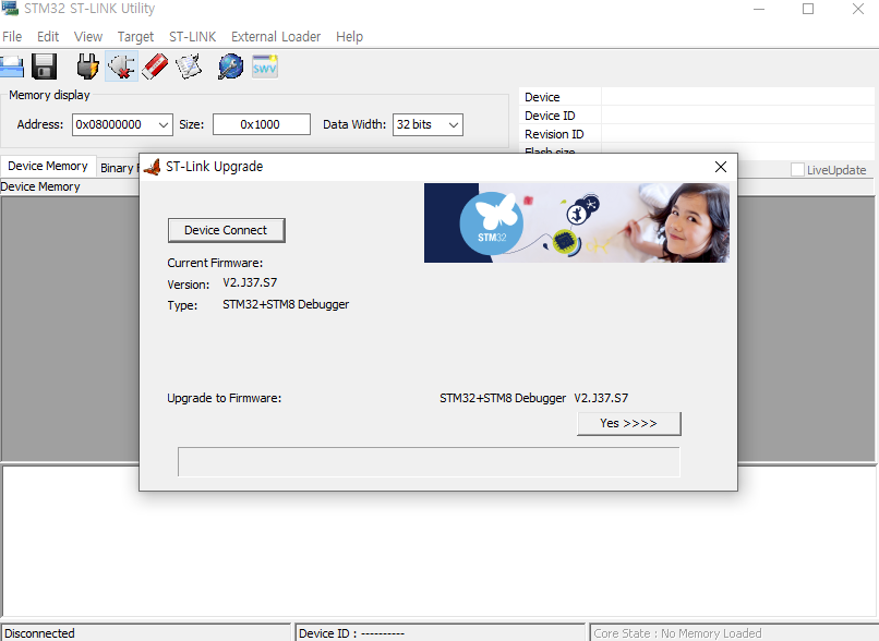

Below is the image which I have used.
AScha.3
October 23, 2023
try with stm32CubeProgrammer . (st-link utility is outdated.)

You have used the ST-LINK utility, which is long out of date and on NRND (Not Recommended for New Designs). The firmware is also outdated and should be updated with STM32CubeProg.

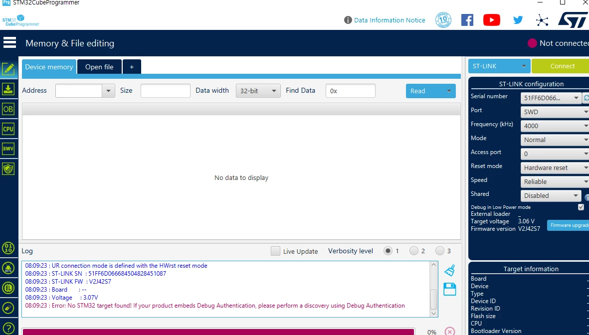

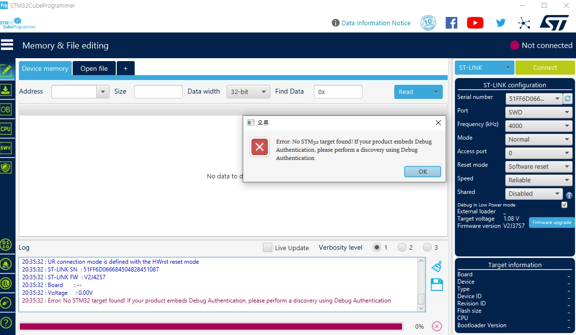

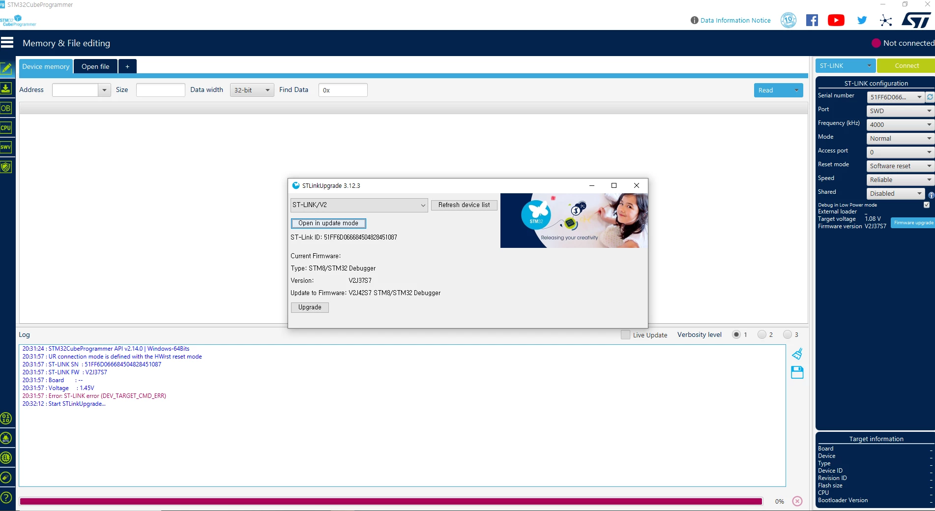

Below is the upgrade using CubeProgrammer after install it.
However,
If i tried to program with connect, below is error message which i got.
Thank advance
BR
AScha.3
October 23, 2023
so st-link working now. ok.
but target shows 0 V only - now power on target ! (or you didnt connect VDD ( 3,3V )to st-link .
connect 3,3 V to target !

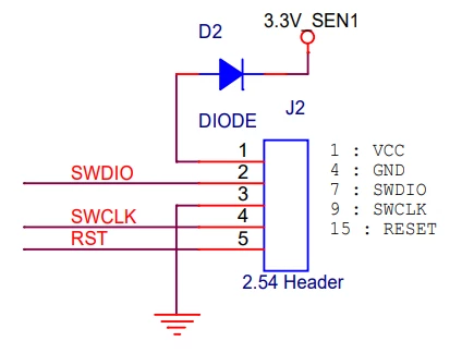

Show how this is connected to your target. Needs VCC, GND, SWDIO, SWCLK minimum.
This type of ST-LINK/V2 does NOT provide a COM Port / VCP
kevin1971Author
October 23, 2023

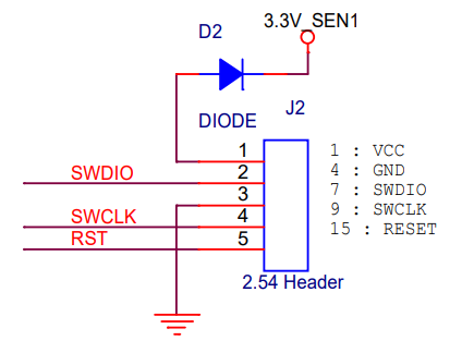

Powre is up with 3.07V. however, no stm32 target found as below image.
My SWIO, SWCLK, VDD, RST as below schematic.
VDD : 1
SWIO : 7
SWCLK : 9
RESET : 15
GND : 4
Thanks in advance.
Regards
Tesla DeLorean
Guru
October 23, 2023
Ok, but the diode suggests that you expect the ST-LINK to power the 3.3V whereas the expectations for the buffers is that your target powers them. Check the voltage you see on pin 1/2 of the 20-pin header
kevin1971Author
October 23, 2023
Hi Tesla,
You mean that the target board should provide the power 3.3V to the st-link VDD pin 1/2 of the 20-pin header.
or,Is 3.07V little bit low voltage for flashing?
Thanks
Regards,
kevin1971Author
October 24, 2023
Hi
After measuring the voltage of 1/2 of 20-pin header with tester,  the value of voltage is 3.13V.
Thank you.
Regards,
