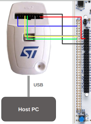

When I switch to an external ST-LINK/V2 and connect
NRST#15 / SWDIO#7 / SWCLK#9 / GND#20 / TARGET VCC#1 / VDD3.3 V#19, programming and debugging work, but the SWV window shows nothing in the STM32CubeIDE.
The reason for using ST-LINK/V2 for SWV debugging is that on our product’s onboard MCU, only VDD, NRST, SWDIO, SWCLK, and GND are exposed.

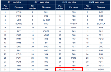

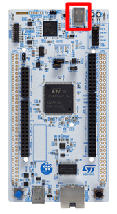

It turns out that the ST-LINK pin short needs to be removed from the power source select jumper JP2 on NUCELO-144. After removing it, the SWV output works correctly when STLINKV/2 SWO is connected to CN12-Pin #31.

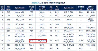

On nucleo board, SWO should be on the MCU pin mapped to PB3.

I have reconfigured the DEBUG mode from Serial Wire to Trace Asynchronous SW, which enables PB3 and regenerated the code.
I first tested with the USB ST-LINK port on the NUCLEO-144 board, and ITM_SendChar worked via SWV in STM32CubeIDE. Then I switched to ST-LINK/V2 and added an extra connection between Pin #13 on ST-LINK/V2 and PB3 on CN12-Pin #31 or CN7-Pin#15 on Nucleo-144 board, but the SWV output still does not show.
