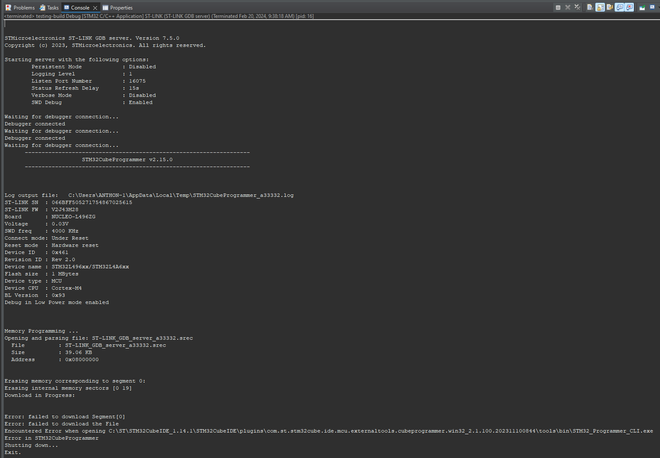

I am trying to simply flash onto my nucleo board using the default configurations that the STM32CubeIDE generates for me. I have detached the ST-Link and connected it externally to the board as shown below:

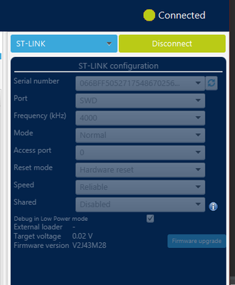

When running the STMCubeProgrammer, the following configurations are shown:
Note: I am not sure why, but the target voltage is extremely low but the stm32 on the board is receiving the 3.3v needed to operate.

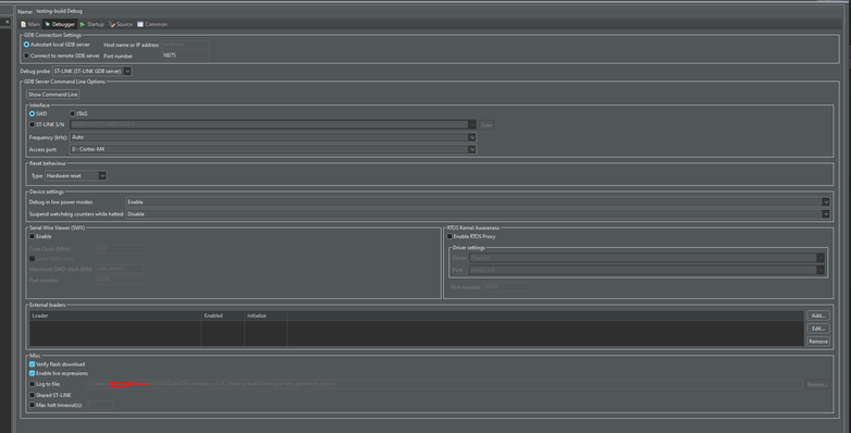

In the IDE, I selected the correct board (STM32 L496ZG-P), and enabled UART4 to use just for an example. When the code is generated, below are the run configurations I am using:
Overall, the memory segments from 0-19 (all 20) gets erased, but I am having issues trying to flash onto the memory segments as shown below:
I have done the following in an attempt to fix this:
  • Download a new driver
  • use older versions of the cube ide
  • configured different UART ports
  • Tried using an External Loader
I don't even know what the problem is honestly. I've gotten about 4 different errors including an error in erasing memory or even expected byte issues. But the most common one is failed to download segment[0]. Any help is appreciated.
