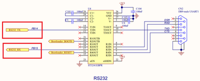

Hie, according to the documentation of the board, USART1 can be used with db9 port by setting up JP7 and JP8 to 1 and 2 ( which I did). The second thing is to connect usart_tx and usart_rx to PB14 and PB15.
The problem is that nothing is showing up on the pc with DB3 port. I've check the tx port with an oscilloscope and I'm getting signal on data sending but only 1.1 V (in AC). I don't know if it's part of the issue but I hope someone has the solution

mƎALLEm
Hello @giorgio29 and welcome to the ST community,
I didn't understand this statement:
Why you need to do that? by setting up JP7 and JP8 to 1 and 2 connects RS232_Tx and RS232_Rx respectively to PB14 and PB15. From the board schematic:
PB14 and PB15. Did you wire something on the board?

Bonjour,
Sorry but why are you using PA9 and PA10 here?
You should configure PB14 and PB15 to use DB9 for USART1 as indicated in the schematic:
giorgio29
Ok I'll clarify.
1 ) I've activated the USART1 in asynchronous mode -> The default pins that were activated were PA9 and PA10.
2) I've changed those pins to match the documention -> The pins are now PB14 and PB15
3 ) I've changed the JP7 and JP8 as the documentation tells.
4 ) After several research, I've put the GPIO Pull up/pull down to Pull up in order to get a 5V output.
5 ) When looking at the tx pin (3rd for db9) with an oscilloscope, I can see data going throught but I can't get it on PC.
6 ) I've tryied several PCs and adapter so no problem there.
Tell me if there is anything not clear enough.
So your UART is now working.
Use the oscilloscope to measure the baud rate - is it correct?
How, exactly, are you physically connecting to the PC?
Note that this is RS232 levels - so you will need a PC connection supporting that.
What application(s) are you using on the PC?
BTW: Strictly, that connector is DE9 - not DB9:
The 'E' denotes the small shell, with a maximum of 9 pins;
The 'B' denotes a larger shell, with a maximum of 25 pins.
See: https://news.sparkfun.com/14298
