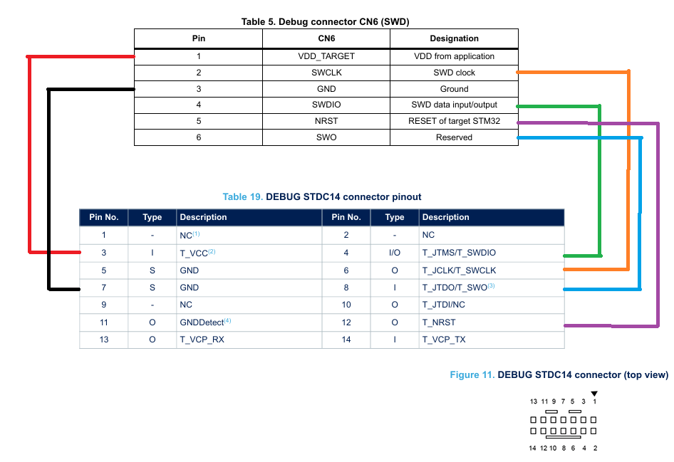

I am trying to link up a Nucleo-F411RE board to a STLINK-V3PWR unit via the SWD (CN6) header.
I am going to make a breakout board for the connector. See image below, I am assuming that I do not have to connect T_VCP_RX and T_VCP_TX to anything on the Nucleo board, am I right?

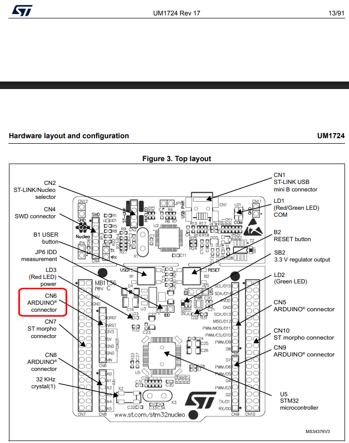

On a Nucleo-F411RE board (MB1136), CN6 is the Arduino power header - not SWD:
https://www.st.com/resource/en/user_manual/um1724-stm32-nucleo64-boards-mb1136-stmicroelectronics.pdf#page=14
via: https://www.st.com/en/evaluation-tools/nucleo-f411re.html#documentation
Did you mean CN2, or CN4 ?

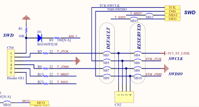

Don't forget that you will need to disconnect the built-in ST-Link before using an external one.
The CN2 jumpers disconnect the SWD lines, but not NRST.
So long as you don't want to use the VCP functions
Ahhh yes I had the wrong datasheet open! Yes I mean CN4.
So after removing the jumpers on CN2 I will be able to program the board via CN4 or just get debug?
No.
CN4 is to allow the Nucleo's ST-Link to program an external target: it is debug out - not debug in.
See the Nucleo-F411RE User Manual (link above) and schematics:

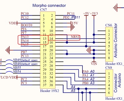

In that case, you would be better breaking-off the ST-Link part of the nucleo, and connecting the STLINK-V3PWR via the SWD (and NRST) pins in the CN7 Morpho connector.
That way you'll avoid any misleading current measurements due to the Nucleo ST-Link...
