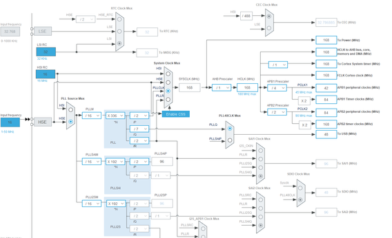

So, for USB I need PLL source from HSE clock: BlueCoin schematic shows that there is a crystal oscillator @16Mhz (NDK NX2520SA) installed directly on the board, so I configured RCC HSE as Crystal/Ceramic Resonator; the problem is that the function HAL_RCC_OscConfig(&RCC_OscInitStruct) in SystemClock_Config retrieves HAL_TIMEOUT as a result. Timeout value is default at 100ms.
Clock configuration in STM32CubeMX is as suggested in the official USB tutorial:

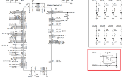

I don't have idea about that BlueCoin board but referring to its schematic, it has indeed a crystal on it of 16MHz:

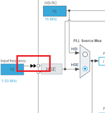

But from what you shared in the CubeMx screenshot, it seems you are configuring HSE in Bypass mode:
Only one pin is used in this case while you need OSC_IN and OSC_OUT for a crystal.

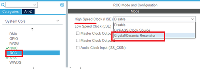

So you need to select Crystal/Ceramic Resonator in CubeMx for your case:
Bypass mode is used for example for crystal oscilators (XO) and not for crystals (XTAL).

1- You mentioned in a previous post NUCLEO-G0B1RE. So could you please confirm your are debugging on STEVAL-BCNCS01V1 that contains a STM32F446 and not NUCLEO-G0B1RE which contains a STM32G0B1 MCU?
2- Check you have that crystal on your board and that was not unsoldered:

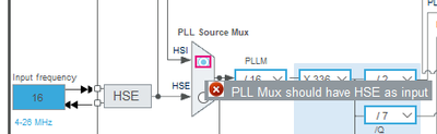

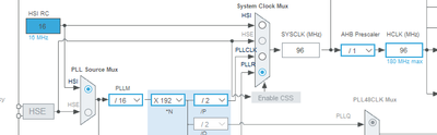

3- Test if you can use HSI as source clock:
This is just for test.

2) The oscillator is present on the board
3) If I switch to HSI, this is what I get (I guess USB-FS needs HSE):
Because USB needs HSE with an external crystal to work properly in this product.
