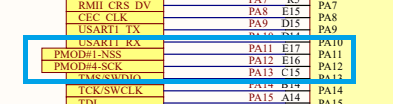

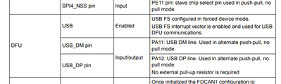

According to the AN2606 the pins to be used for DFU are PA11 and PA11 in USB full speed:
But according to the STM32H747I-DISCO board schematic only USB HS is available on the board and PA11/PA12 are used for other purpose:
So unfortunately you cannot use DFU mode with this board.

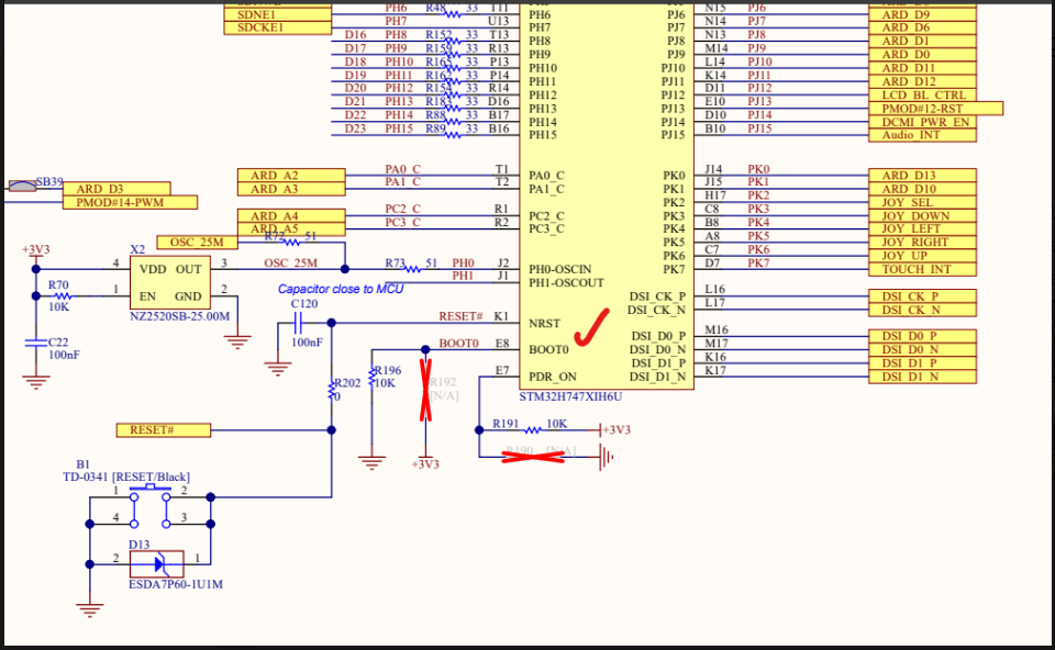

Hi, could you confirm the location of the boot0 pin, where might the boot pin lie on the STM32H747I-DISCO board. I have read the documents but there is nothing mentioned about the boot pin related to dfu, and I have also checked the board, but I couldn't find a dedicated pin or a jumper related the boot pin. In the schematic there is an R192 which connects with the Boot0, do we have to short it? We tried shorting it with a jumper wire but it didn't work. If you know anything about this issue, then kindly let me know about it, thanks.
Starting system bootloader is described in Table 2 Patterns AN2606. And yes R192 is pinout for solder wired button switch or jumper. But as mƎALLEm
USB on this board isnt connected to DFU USB pins. Then for use it you require change board and add connector for USB FS.
Better and simpler is try use one UART based on AN2606 and load firmware  over it and (any USB UART bridge for PC), when STLink isnt ok.
Yes that's the Boot pin but as I said you cannot use DFU mode on this board.
