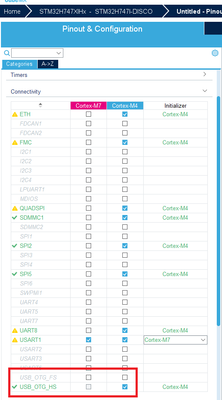

Hey everyone, I'm working with the STM32H747I-DISCO board and trying to get it into USB DFU mode to flash firmware using STM32CubeProgrammer. However, the board isn't being detected, and I couldn’t find clear instructions in the documentation about how to properly enter DFU mode. If anyone has managed to get this working or knows the correct steps, I'd really appreciate your guidance. Thanks in advance!

The hardware to be used is described in the AN2606 and there is no specific bootloader document for ST boards as the bootloader is silicon specific not to the board.
And starting a project from STM32CubeMx based on the STM32H747I-DISCO board, the USB FS is not enabled by default. Only USB HS is enabled:
Hope it's clear now.
