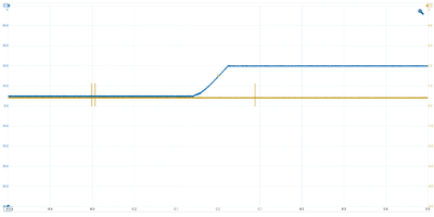

I have edited src1m1_usbpd_pwr.c and added in the osDelay call. It gives me a delay.

Then I use a script to both push the button in the STM32CubeMonitor UCPD window and remotely change the voltage of my PSU. I am able to slip the voltage rise nicely between the ACCEPT and PS_RDY messages.

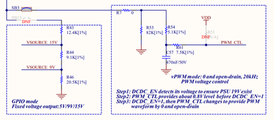

How to enable 20V operations?
  • You need to implement your own external PCB capable of switching or providing the 20V output after PD negotiation.
  • You can follow the STM32G0 evaluation daughter board schematics, as a reference for your hardware design.
  • On the firmware side, in the USB PD stack (specifically in usbpd_dpm_user.c), you can define the PDOs supported by your design. By default, the firmware provided defines only a 5V PDO in the PORT0_PDO_ListSRC structure.
To support 20V, you need to add a 20V PDO in your source application firmware to allow the PD negotiation to accept 20V as a valid power profile.
