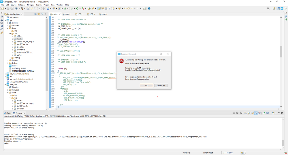

Original title: Facing a debug issue. the code works in another board and gets firmware update. but its not working in my current stm32f103zet6 customized board.

and i checked in st link utility ,the firmware is upgrading but in stm32cubeprogrammer its not even connecting when i try to upgrade it its started upgrading at the end its saying the st link connection is lost ..whyy??

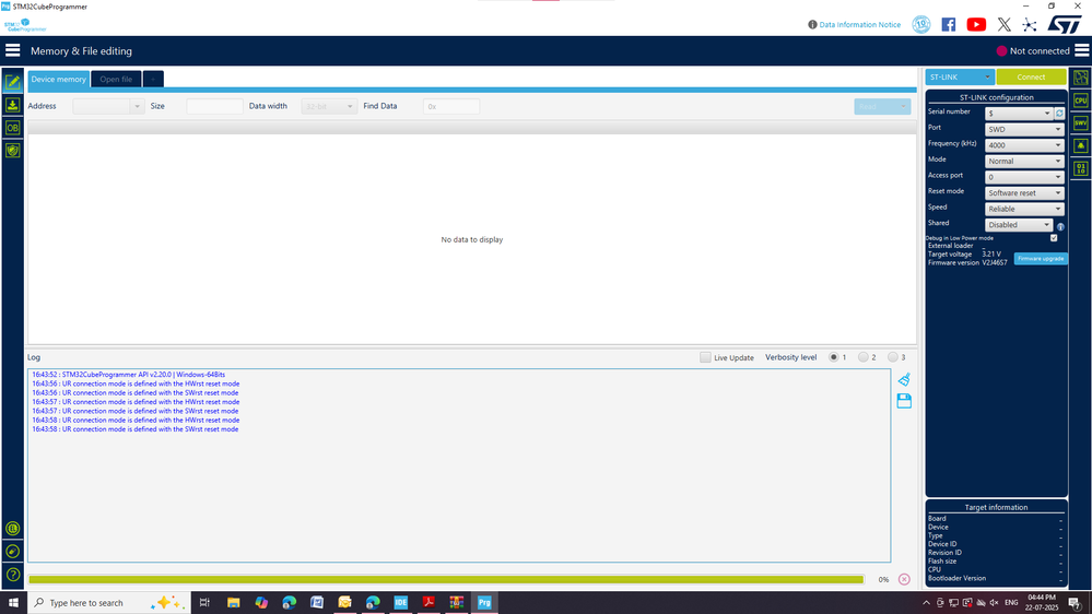

Please show the full log from CubeProgrammer; also a screenshot.
anuradha
It worked after erasing full chip. But i have a question In my stm32cube programmer whenever i connect my target board its showing the only message like "Ur connection mode is defined with HWrst reset mode .Iam using 2.20.0 stm32cube programmmer version
I put mode: under reset
reset mode: hardware reset
and if i click option bytes option also its still sending the same message....

 message like "Ur connection mode is defined with HWrst reset mode....
Please show the actual message.
And a screenshot showing your settings.

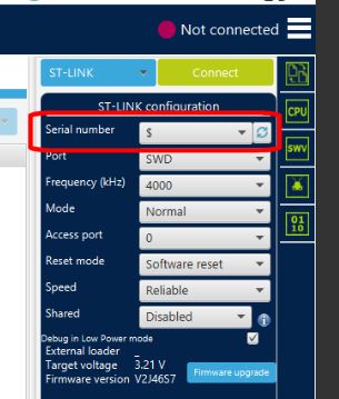

This is not a valid ST-Link serial number:
So your ST-Link is either fake or faulty - or both.
Again, see: How to recognize a genuine ST-LINK/V2 versus a cloned one.

Yeah it's worked another board means both have same serial chip number,same schematic ...okay I understood ,the launching debug issue is solved what my question is about st link v2 detection fail in cube programmer. i used another st link v2 its detecting but my stlink v2 debugger works in st link utility and gives result .so in there its works means why it's not work here? is it still debugger issue
You still haven't answered the question: is your ST-Link genuine, or a clone?
Again, here is how to check:  How to recognize a genuine ST-LINK/V2 versus a cloned one.
In particular, see:
https://community.st.com/t5/stm32-mcus/how-to-recognize-a-genuine-st-link-v2-versus-a-cloned-one/tac-p/703663/highlight/true#M965
Show picture of board and ST-LINK.
Show picture of STM32103ZET6 IC that's problematic, large, clear and in-focus if you can manage that.
Details so far suggest you are working with fake/counterfeit parts.
