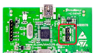

2- Are you sharing the board with other people? if yes that's indeed an issue and need from you ton contact these people to ask them what they modify on the board: unsolder solder bridge, remove some components from the board etc .. we don't have a full picture..
3- What about the following jumpers? are they fitted?
1-I tested my code with the GJA25, and it worked the first time. However, the second time, a launch error appeared.
2-No, it is a new board. I only tested it twice, and I did not share it with anyone.
3-Yes, the jumpers are present and correctly fitted

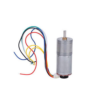

What do you mean by "GJA25"?
a motor encoder
@raniaa wrote:
a motor encoder
That's indeed a missing information you would provide from the beginning.
Do you mean this motor?:
If yes how did you connect it?
How did you connect the motor itself (I'm not talking about the encoder) but about the motor itself? directly or over a power stage dedicated to interface a such kind of motors?
 i've used a power stage (l298n motor driver )
