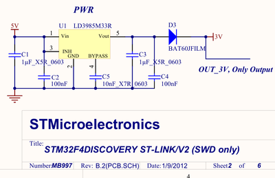

-Also, the 2.89V is suspicious
-also, do you feel like the MCU itself gets overheated?
can you test the voltage at MCU level and see what you get? maybe the board voltage regulator becomes faulty
which lead to some corruption when flashing the memory: (don't forget to remove the jumper before measuring)
-Also, can you try to connect it using the under-reset mode then reprogram RDP to 0xAA enable BOR and do a power cycle

I measured the voltage directly on the MCU VDD pins using a multimeter, and I get around 2.93V

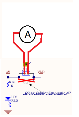

The idea here is to remove JP1 and measure the voltage of the power source side on that jumper. The purpose is to detect if there is a voltage drop on the voltage regulator output while powering supply the MCU.
I get around 2.94V
Voltage seems ok
try measure too current over removed jumper.
Measured current across J1 after removing the jumper: 0 A. Same result observed on a known good board
How did you measure the current? 0A doesn't make sense.
You need to measure the current consumption on both pins on JP1 as the following:mALLEm_0-1776804141013.png
I think there is an issue with my multimeter because I'm getting a reading of 0 on both boards
there is not another test ?
