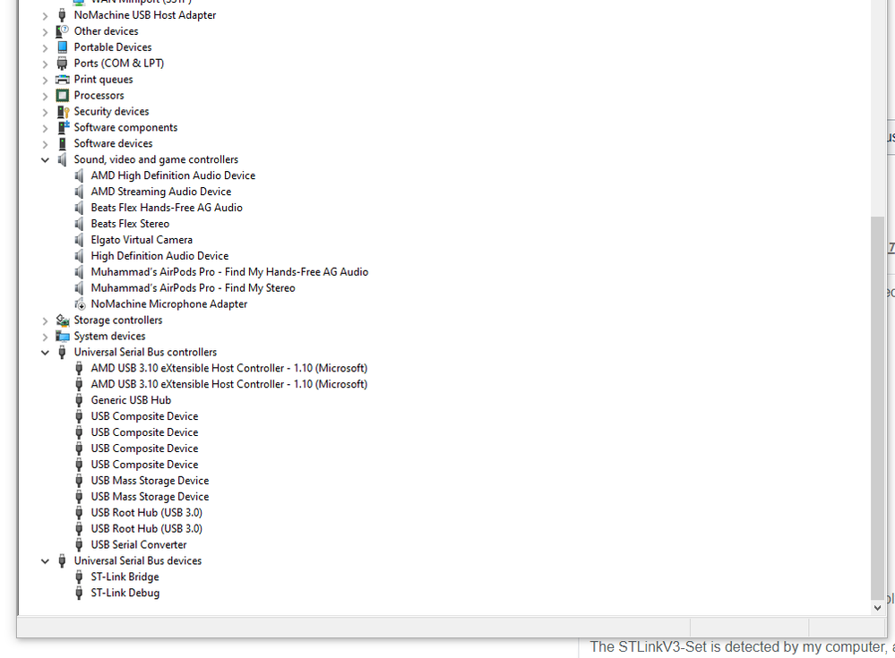

I have a custom STM32 Board that is supposed to act as a flight computer. Currently I am having trouble connecting to the STM32F4 chip over SWD.
I am using a STLinkV3.
I can read the following voltages:
  • Vdd = 2.4V
  • Vda = 3.3V
  • Boot0 = 2.4V
  • Boot1 = GND
  • NRST 2.4V
  • Vcap = 1.3V
I get the following error when connecting over openocd:

My power system might be limiting current supply to the board to 50mA. Which when looking into it should be fine.
The STLinkV3-Set is detected by my computer, as seen in the following image.

Your BOOT0 should be pulled low, not high.

I wanted to use the System Memory when configuring the bootloader, is there a particular reason that would be a bad idea when connecting over SWD?
I have a way to set the Boot0 pin to low using one of the switches. So I will try that!
