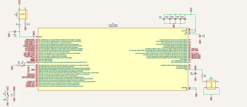

I am trying to program a custom STM32F446 Board using the SWD connections on the board. When trying to flash the custom board I receive the following error on OpenOcd:

I have a 6 pin 01x06 pin male connector on the custom board for SWD, which connects to the appropriate pins on the STM32. Here is the board connection schematic:
Hopefully the image is visible.

3 REPLIES 3
Liferafter
I might be the dumbest person alive (atleast from what I have read online :) )
You need to provide the STM32 with your own external power, the STlink SWD Vcc connection doesnt power the board  itself!
I added an external source, and tried again but this time the init failed:
Heres the error message:
xPack Open On-Chip Debugger 0.12.0+dev-01312-g18281b0c4-dirty (2023-09-04-22:32)
Licensed under GNU GPL v2
For bug reports, read
        http://openocd.org/doc/doxygen/bugs.html
Info : auto-selecting first available session transport "hla_swd". To override use 'transport select <transport>'.
Info : The selected transport took over low-level target control. The results might differ compared to plain JTAG/SWD
Info : Listening on port 6666 for tcl connections
Info : Listening on port 4444 for telnet connections
Info : clock speed 2000 kHz
Info : STLINK V3J13M4B5S1 (API v3) VID:PID 0483:374F
Info : Target voltage: 3.290606
Error: init mode failed (unable to connect to the target)
This might be hardware issue but I cannot tell
NRST is getting voltage (~3.3V) so its driven high
The STM32 Chip also has a constant 3.3V on the VDD.
Cant figure out why the OpenOCD or STM32CubeIde cant find target.
