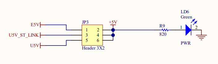

We want to turn on the LED when the microcontroller is powered on. Before the program is executed.
Is it possible to achieve this with just the program, without changing the HW?
Specifically, we want to program LD6(PWR) of STM32F412G-DISCO.
Best answer by Andrew Neil
But that LED is not programmable: it is hard-wired to the 5V supply - there is no connection to the STM32:
https://www.st.com/resource/en/schematic_pack/mb1209-f412zgt6-d04_schematic.pdf#page=4

Isn't that done with JP3...

October 15, 2024
Thank you for your answer.
Sorry for being st*pid. What does JP3 mean?
PGump.1
Senior II
October 15, 2024
Look on STM32F412G-DISCO for JP3...

Senior III
October 15, 2024
You can connect one transistor with its input biased to turn it on, connect the base curcuit to one gpio. At boot time gpio is in input mode. When the program runs, you can turn off the transistor. Hope this helps.  You can fine tune this idea with mosfet, optocoupler etc...
October 16, 2024
Thank you for your response.
I see that the LED was coming directly from the 5V supply.
Now that I understand, I will close it.

October 16, 2024
In the default design, LD6 is not programmable.
if you want to program LD6, the way is :
Step1: To remove R9.
Step2: To connect a GPIO(you can use resource from Arduino connector) to LD6 directly.
Step3: Program the GPIO you use.
Note that, brightness of LD depends on GPIO output capability.
Andrew Neil
October 16, 2024
@Sco wrote:
Step2: To connect a GPIO (you can use resource from Arduino connector) to LD6 directly
Don't connect directly - connect via a suitable resistor!
