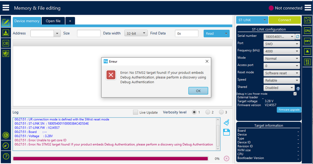

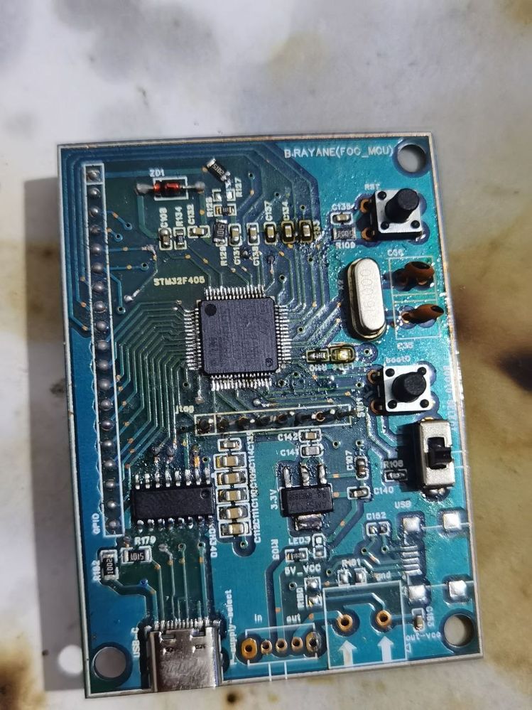

I have recently made my own STM32 board based on the STM32F405. After soldering all the components and testing all pads and connections, finding them to be wired correctly and checking that the 3.3V is being supplied to all the correct pins, I tried to upload some code, but to my shock, the STM32F405 isn't establishing a connection via the ST-Link V2 nor the USB cable. After trying multiple fixes, I suspect the issue might be the STM32F405 chip that I got off AliExpress itself.
Before taking any further steps to replace it, I decided to post a question here for review in case the problem was in my PCB design. And sure enough, I had misplaced the chip pin due to the faulty pinout diagram I used as reference.
I have since fixed the chip's orientation and rechecked all pad and pin connections, as well as the 3.3V supply, and found everything to be correct; yet I still cannot get the STM32 CubeProgrammer or IDE to connect with my board using the ST-Link V2 or a USB Type-C.
If you have any remarks on what might have caused this problem, please share them.
NOTE: The -B label is referring to ground, and P is the VCC.

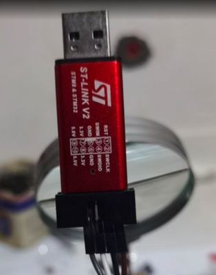

The serial number of your "ST-LINK/V2" shows only the letter E, so I assume that it is a clone that is not supported (see here).

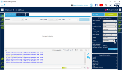

Hello again. Sorry for taking so long; I had to find a working ST-Link V2 and tested it. You were right; the ST-Link was a nonfunctional clone. After using a different one that worked fine with the blue and black pill, I still get this error. if you have any idea of what it might be from, please share your thoughts

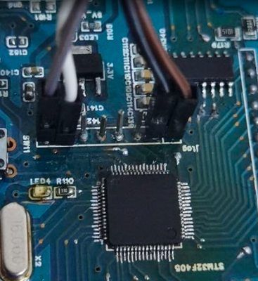

@rayboum Good point: I only now looked at the photo and noticed that you apparently didn’t layout something correctly. The crystal is indeed connected correctly to pins 5 and 6, but at least the JTAG connector is apparently on the wrong pins.
[edit]Sorry, I was too quick, the JTAG looks connected correctly, but lets doublecheck your ST-LINK/V2: please insert a legible photo, front and back.[/edit]

Yes, here are the pictures.
I understand that the ST-LINK link I am using is still a cloned one. The one I used previously was completely faulty and didn't even work with the blue or black pill. The red one, on the other hand, belonged to a classmate of mine that used it to regularly program them, so I decided to use it before committing to buying this one, as it is somewhat expensive for a student budget (I still need to buy other components) and it's the only other ST-LINK model currently available in my country.
