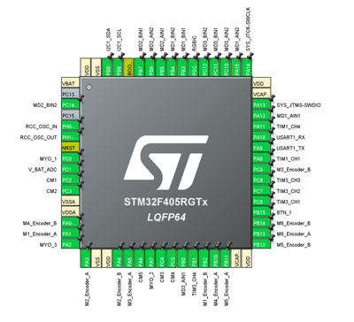

I am using the STM32CubeIDE software and have configured all GPIOs. I having trouble with PA12 and PA15 in particular. See GPIO Mode and Configuration:
I use pin PA12 (MD1_AIN1) and PA15 (MD1_AIN2) for the choose the direction for a DC motor.

As seen both PA12 and PA15 should be RESET = LOW.

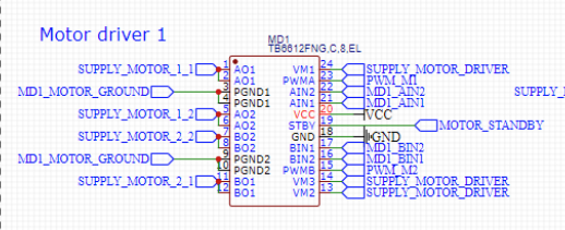

See drawing for motor driver:

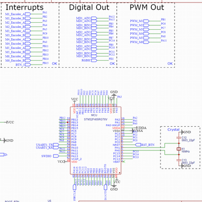

Drawing for MCU (under Digital Out):
Does anybody know why there I have constant 3.3VDC over PA12 and PA15?

Yes, you need a 2u2 F capacitor on each VCAP, or connect them and use a 4u7 F one
Part will malfunction without them. Should be able to measure around 1.25 V at these pins.

1. Which part are you referring to? I am able to program the MCU yes, I have tested  PB15, which is a button and it works fine.
2. As you can see in the image below I do not use the VCAP pins. Is this necessary?

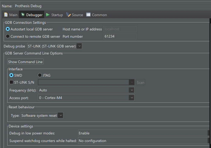

5. Do you mean the Debug Port for SWD/JTAG?
I am using an ST-Link V2 which is connect via SWD.
Here is my debug configuration:

Hey @Tesla DeLorean!
I did as you suggested and connected the VCAPs with a 4u7 F capacitor.
This seemed to solve my problem.
