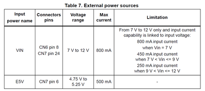

2023-12-09 07:30 AM
As far as I know the external power supply for STM32F401re Nucleo board is 7V > & < 12V.
2023-12-09 07:37 AM
Sorry, 5V on E5V. what you say is correct for the VIN pin.

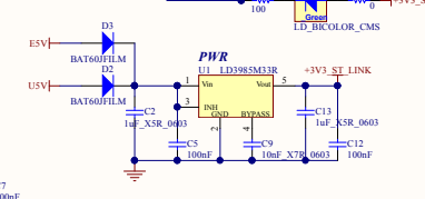

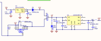

2023-12-09 08:43 AM
thank you for your reply AScha.3
I am just using this schematic as a guide. I am attaching screenshots where apparently it is the same to feed by USB or E5V but for some reason it generates a different effect.
or did you mean that it is OK in the second question to connect via USB while JP5 is configured to power the board with external 5V on E5V?
2023-12-09 10:00 AM
right. JP5 on 2-3 powers the F401 by external 5V .
and the stlink also - or by usb (by the diodes d2, d3 ).
