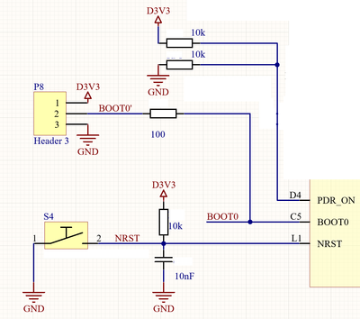

BOOT0 is selectable with a jumper.
PDR is set with 0R resistors. Currently PDR = VDD.

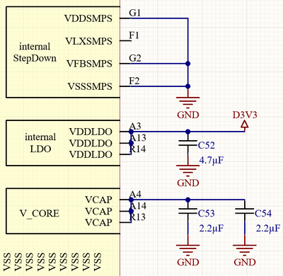

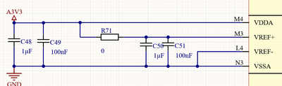

VDDA and VREF+ are connected to 3.3V.
The rest of the supply is external according to the data sheet.

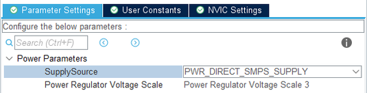

The solution to the problem was in the software, more precisely in the configuration via the IOC file.
Since the internal LDO was wired directly in my circuit, the corresponding bit must also be set
In my error case, the microcontroller loaded the hardware configuration after flashing and switched off its own power supply
