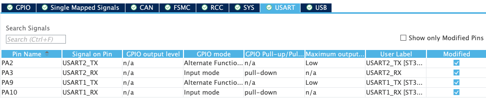

STM32F103 UART interrupt not working
Smdeint
Hello, I'm building a project where I will use CAN, UART and a TIMER. All of these work with an interrupt. How it works: I get data via CAN and use a TIMER to send a Request on the CANbus. With the UART I need to receive some commands that will trigger some functions. I have provided my code. In this code everything is working except for the UART interrupt. I had a different project with UART where everything was in the main, so I copied that to see if that is working, but it doesn't work. The UART interrupt is not getting triggered, but in the separate project it is working where I only use UART. What is wrong?

I got it working. I didn't look at the PIN settings. The receive pin (PA3) of USART2 was set to GPIO mode, but it should be input mode. afbeelding 2024-01-23 at 13.18.26 (2).png
6 REPLIES 6
mƎALLEm
Did you activate the interrupt for the UART? (check if the NVIC interrupt line for your UART is configured).
Yes, I activated the interrupt for UART, CAN, TIMER.
Try to isolate UART functions and built a simple application with only UART and see if the issue still happen.
So I followed this link https://wiki.st.com/stm32mcu/wiki/Getting_started_with_UART#UART_with_Interrupt to test if it was working, but this also doesn't work. The interrupt won't trigger. Below is the code.
Well, that's why you need to isolate the function having the issue to surround it quickly ;).
