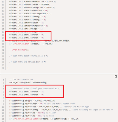

is there any simple example for (STM32G0B1CBT6) or similar where I can simply filter int genration for eg. only for 0x505 id in standart mode. I tested many samples and I believe that there must be some bug in IDE. This is

  FDCAN_FilterTypeDef sFilterConfig;
  /* Nastavení počtu filtrů pro standardní ID */
  hfdcan1.Init.StdFiltersNbr = 1;
  hfdcan1.Init.ExtFiltersNbr = 0;
  sFilterConfig.IdType = FDCAN_STANDARD_ID;
  sFilterConfig.FilterIndex = 0; // Use the first filter bank
  sFilterConfig.FilterType = FDCAN_FILTER_MASK; // Specify the filter type
  sFilterConfig.FilterConfig = FDCAN_FILTER_TO_RXFIFO0; // Store matching messages in RX FIFO 0
  sFilterConfig.FilterID1 = 0x505; // filter
  sFilterConfig.FilterID2 = 0x1FF; // mask
  if (HAL_FDCAN_ConfigFilter(&hfdcan1, &sFilterConfig) != HAL_OK)
      Error_Handler();

I have played and tried many changes in  sFilterConfig.FilterID2 = 0x1FF; // mask 0x505 and other items.  If I comment or delete HAL_FDCAN_ConfigGlobalFilter then any ID generates interrupt data comes from all id  correctly but it does not filter for 0x505. if using  HAL_FDCAN_ConfigGlobalFilter then it does not generate any int doesnt receive.

Hello @JD3 ,
Your standard filter number is set to 0. Need to set it at least to 1.
hfdcan2.Init.StdFiltersNbr = 0;
I think it is set to 1 as iam not using extended id, using only FDCAN1:
Karl Yamashita
Principal
You've initiated for hfdcan2 but you're setting the filter for hfdcan1.
Or, you're not showing all your code.

Thanks my mistake, i have posted wrong one but i initialize both FDCAN1 and 2 but using only FDCAN1. Is there any relation to filtering if using both?

But here again Standard filter number is set to 0! for both FDCAN1 and FDCAN2:
  hfdcan1.Init.StdFiltersNbr = 0;
No.
You need to configure the HAL driver for the number of filters you are going to use
// You can add up to 28 filters for STD ID, and up to 8 filters for EXT ID.
hfdcan1.Init.StdFiltersNbr = 28;
hfdcan1.Init.ExtFiltersNbr = 8;
hfdcan2.Init.StdFiltersNbr = 28;
hfdcan2.Init.ExtFiltersNbr = 8;
// Or, if you have only 2 STD ID and 0 EXT ID
hfdcan1.Init.StdFiltersNbr = 2;

REason was that i did not include it to
static void MX_FDCAN1_Init(void)
  /* USER CODE BEGIN FDCAN1_Init 0 */
  /* USER CODE END FDCAN1_Init 0 */
  /* USER CODE BEGIN FDCAN1_Init 1 */
  /* USER CODE END FDCAN1_Init 1 */
  hfdcan1.Instance = FDCAN1;
  hfdcan1.Init.ClockDivider = FDCAN_CLOCK_DIV1;
  hfdcan1.Init.FrameFormat = FDCAN_FRAME_CLASSIC;
  hfdcan1.Init.Mode = FDCAN_MODE_NORMAL;
  hfdcan1.Init.AutoRetransmission = ENABLE;
  hfdcan1.Init.TransmitPause = DISABLE;
  hfdcan1.Init.ProtocolException = DISABLE;
  hfdcan1.Init.NominalPrescaler = 2;
  hfdcan1.Init.NominalSyncJumpWidth = 1;
  hfdcan1.Init.NominalTimeSeg1 = 13;
  hfdcan1.Init.NominalTimeSeg2 = 2;
  hfdcan1.Init.DataPrescaler = 1;
  hfdcan1.Init.DataSyncJumpWidth = 1;
  hfdcan1.Init.DataTimeSeg1 = 1;
  hfdcan1.Init.DataTimeSeg2 = 1;
  hfdcan1.Init.TxFifoQueueMode = FDCAN_TX_FIFO_OPERATION;
  if (HAL_FDCAN_Init(&hfdcan1) != HAL_OK)
    Error_Handler();
  /* USER CODE BEGIN FDCAN1_Init 2 */
  /* USER CODE END FDCAN1_Init 2 */
respectively did not set it in .ioc  .. now everything works fine
