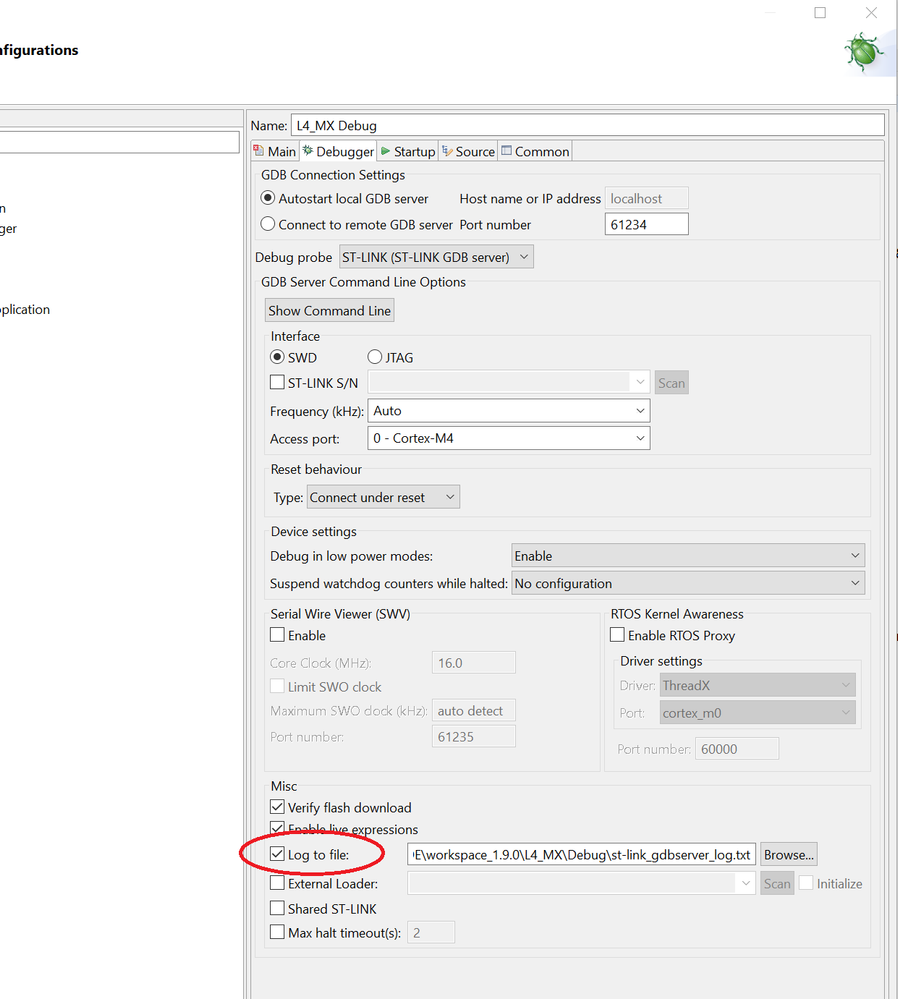

Did you create a debug configuration for an "STM32 Cortex-M C/C++ Application" or some other type of debug configuration?
You could activate the gdbserver log in the debug configuration. Then if you could post the gdbserver log and the .launch file that's in the root of your project then I could probably get a more clear picture of what goes wrong.
AlexCloned
Senior
Thank you. Yes @Markus GIRDLAND​ y created a debug config and checked "log file". But log is not even created when trying to debug. Then I manually created the log file, browsed for it from the debug config. I started debug, but the log file never updates. It remains empty. It seems debug is aborting when trying to start.
