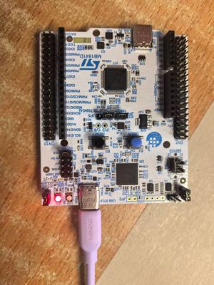

I am using NUCLEO-U545RE-Q with X-NUCLEO-NFC07A1.
After downloading a program via Arduino IDE, the board got locked.
Symptoms:
  1. PC cannot detect the board, no ST-LINK device, no COM port
  2. ST-LINK LED: red always on, green flashing
  3. STM32CubeProgrammer cannot connect, error: No debug probe detected
  4. Connect Under Reset does not work
What I tried:
  1. power cycling
  2. holding RESET when plugging USB
  3. Connect Under Reset in CubeProgrammer
  4. checking CN2 jumpers (they are fine)
Questions:
  1. How can I unlock or erase this board without a BOOT0 jumper? It seems not available on this NUCLEO board.
  2. Is there any software-only way to recover the SWD?
This board is for a competition. Any help is appreciated. Thanks.
BOOT0
BOOT0 can be set to 1 on CN7 connector by bridging pin 5 and pin 7.
BOOT0 is also dependant of the option bytes nBOOT0 and nSWBOOT0:
LD3 is off meaning the ST-Link has not activated the T-PWR_EN signal.
Please, check the quality of the USB cable, and if it is not a charger only cable with no D+/D- data lines.
