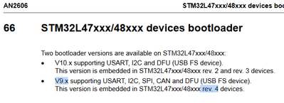

At first, i checked my version of bootloader.
My stm have rev.4. From AN2606 - this is bootloader V9.x.
Bootloader activation is on pattern 7.

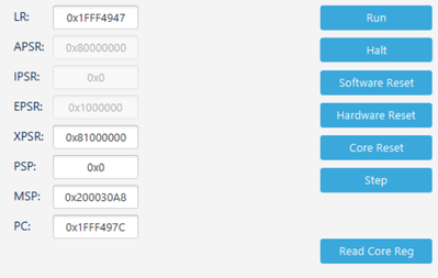

I activated bootloader and I did it correct, because in the CPU tab, when the core is Run and then Halted, the ProgramCounter is in the 0x1FFF XXXX range

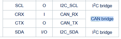

External STLINK-V3PWR CAN bus pins (CRX,CTX) I connected to external transceiver sn65hvd230. This transceiver have powersupply from nucleo too.
STLINK-V3 TVCC to 3.3v nucleo, STLINK-V3 GND to GND nucleo.
Second transceiver sn65hvd230 are connected to PB8, PB9. Power supply from nucleo

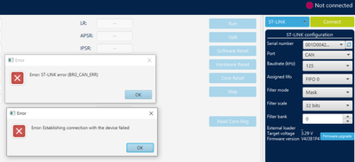

Unfortunately, there is no feedback from nucleo while trying to connect by external STLINK-V3, by CAN bus.
I checked on oscilloscope and signal from STLINK-V3 is going to nucleo correctly.
Any ideas?
