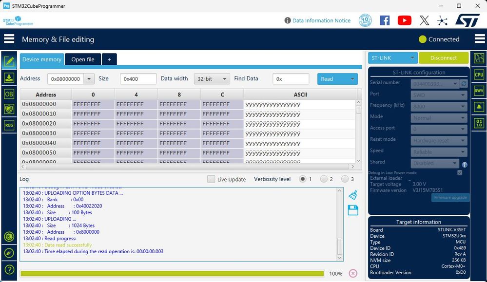

Stlink V3 SET

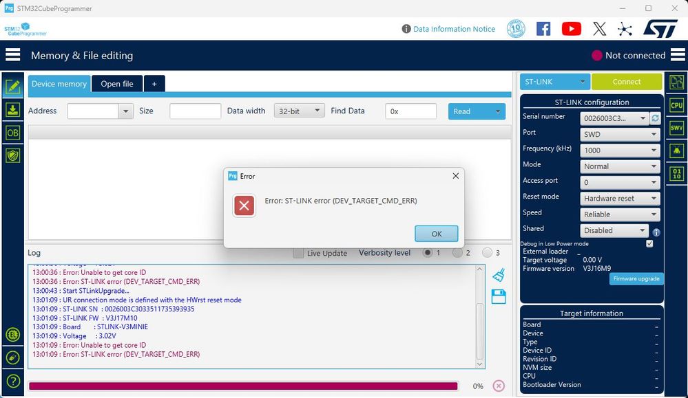

Stlink V3 MINIE

Concerning the signal behavior, it is explained because the V3MINIE embeds level shifters without output enable signal. So outputs (including SWCLK) are always driven. This remark applies also to T_JTDI and T_VCP_Rx. SWDIO can be released because it is bidir and thus can be configured as input for the ST-Link (so not driven by the level shifter).
One point following this difference with V2 and V3SET, is that T_VCC (input for V3MINIE on pin3) is absolutely mandatory for the V3MINIE to work. I don't know if this can explain the issue with CubeProg (because I see 3,02V in the log windows and 0V in the GUI at the right), but I would say this should be the first signal to check in case of connection issue with V3MINIE vs V2 and V3SET (other signals should also be checked, because I guess that connectors differences lead to manual wiring with possible erratic contact)
On miniE target shows 0,0V !  this cannot work.
So power the target. (or you didnt connect the miniE VCC sensing ?)
miniE dosent give out power / 3v3  !
try connect with "software reset" setting.
The MCU is, of course, powered, and VCC is connected to MINIE. Just to be sure, I also measured the voltage at MINIE and verified that there is 3V coming from the MCU.
Connecting it "under reset"—whether via hardware or software reset—has no effect on this, and the result is the same.
