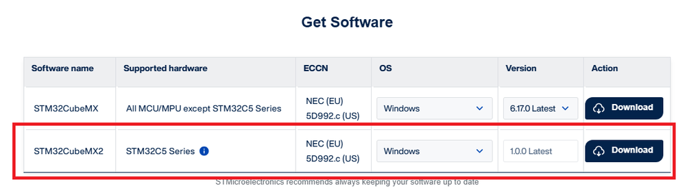

STM32CubeC5 package is now available here for download.
And CubeMx2 is available here for download:
Keep an eye to the list of articles with label STM32CubeMX2. You can subscribe to get notification about any new article there.
