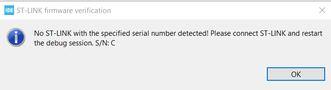

usually I have Nucleo's that I work with, but I also have an older Clone that I purchased a long time ago when the genuine ones were not available.
I noticed that after a firmware-update within STM32CubeIDE 1.10.1 the Serialnumber is "odd" and it would not detect the target, so I wonder if it is a cabeling-issue or if ST has bricked those?
Does anyone know what is going on?
Thanks a lot, Seppel

seppeltronics_v
December 5, 2022
for the STM32CubeIDE 1.10.1 I can say:
  • "On Board" debugger of the Nucleo there is no issue.
  • Clone with older firmware (2020?, havn't used it since years) there is no issue.
  • Clone with latest firmware, single digit serial and cannot connect (same cable):
It seems as ST bricks the Clones, but I have no official statment yet, I have asked the suport on this. Not sure why they do it, the V3's are no so cheap, that will make the Clones obolete anyway. Why bother with a slower debugger if you can have the faster one for little more and be sure it works.
However, knowing that these V2 Clones are used by a lot hobbyists, mostly not because they are much cheaper, but because STLinks were mostly sold by B2B shops, it creates a pile of electronics waste. Not really what the planet needs.
Best Regards, Seppel

Pavel A.
December 5, 2022
What "serial number" is visible in Windows device manager? or lsusb on Linux?
Have you tried the OpenOCD based debugger?

Pavel A.
December 6, 2022
> how to do that on a Windows-machine
If you have the old good ST-LINK Utility: Target->Settings will show "serial numbers" of all connected ST-Links.
Else...
  1. highlight a ST-LINK in the device manager default view (Devices by type)
  2. Select View -> Devices by connection and find your ST-LINK (highlighted)
  3. If it is a function of a composite device, go up to the 'USB composite device'.
  4. Properties-> Details->Device instance path
The instance path should look like
USB\VID_0483&PID_374E\001D00273137510939383538
The last part 001D00273137510939383538 is the "serial number".
There should be no & chars after the PID_xxxx\ part
Are the "serial numbers" on your chinese dongles same as CubeIDE/Programmer shows?

seppeltronics_v
December 14, 2022
sorry for the late reply, I was a little busy.
ST-Link with the latest Firmware:
ST-Link with an older Firmware:
The PCB is ok, but many componets are missing to the genuine, and worst of all, a unknown controller (laser-marking removed), so I can't even repurpose the unit.
With the availability of the genuine debuggers via known channels, it's not interesting to buy these. Value for money may be "ok", but given the fact that for a little more you can buy a genuine one that you know it will work, a bad deal.

Pavel A.
December 15, 2022
@seppeltronics_v​
Ok, so the latest firmware indeed has the serial number string "C".
The software displays it correctly. The question is, does the software demand a longer string (and why)?
The older firmware does not have the serial number at all.
