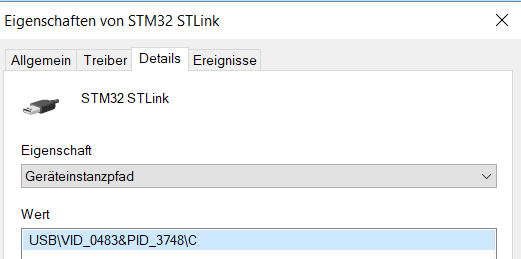

ST-Link with the latest Firmware:

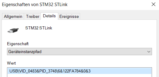

ST-Link with an older Firmware:

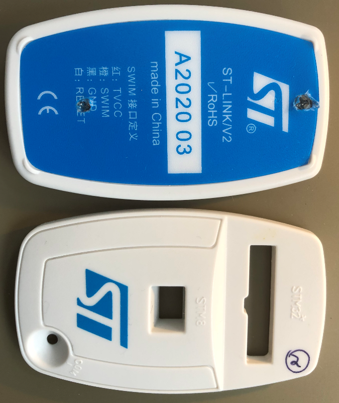

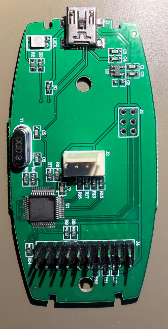

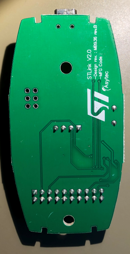

The PCB is ok, but many componets are missing to the genuine, and worst of all, a unknown controller (laser-marking removed), so I can't even repurpose the unit.
With the availability of the genuine debuggers via known channels, it's not interesting to buy these. Value for money may be "ok", but given the fact that for a little more you can buy a genuine one that you know it will work, a bad deal.
Best Regards, Seppel
P.S.

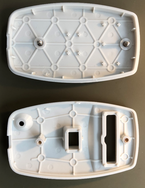

The injection-molding is good, maybe even done same mold as the genuine. The ribbing, the supports,.. or they have really put in a lot of effort.

Ok, so the latest firmware indeed has the serial number string "C".
The software displays it correctly. The question is, does the software demand a longer string (and why)?
The older firmware does not have the serial number at all.
