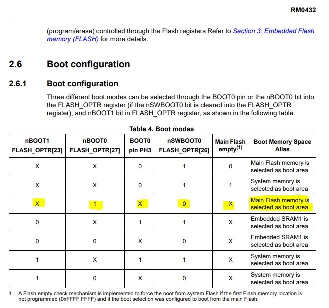

I am doing a pcb layout with a STM32L432KCU6 and using 100% of its 32 pins in my project. BOOT0 signal is on pin 31 on that MCU and in my schematic I have a digital output on that pin (PH3). There is no pull-down/up on BOOT0 on my design.
Programming will be via SWIO/SWCLK/SWO/RST/VCC/GND and I want it always boot from flash.
Is there any way to program the chip (write some config bits) to disable the use of pin BOOT0? How is that done?
I am new to SMT32 micros.
REgards.
Yes, take a look at the option bytes. Set nBOOT0=1, nSWBOOT0=0 to always boot from flash.
