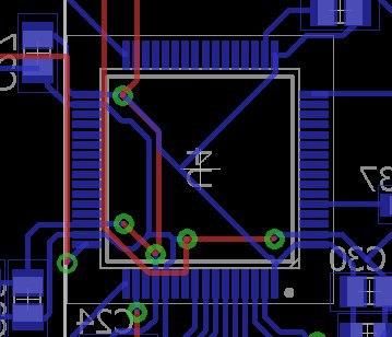

0693W000001cLwVQAU.jpgHello,
I'm doing the layout of a PCB with a STM32L433RCT6 . On the datasheet seems that this micro doesn't have a thermal pad. Also in the libraries I downloaded from Mouser , there is no thermal pad. I'm new with this family of microcontroller so my question is does the micro have the thermal pad ? Can I place vias under it (see picture).
Thank you
Riccardo

No. there is np thermal pad.
thanks for your response. What does it mean "np thermal pad " ?
Thank you
Riccardo
andy2399
Senior
Its a typo he is confirming that there is NO thermal pad on this device.
Andy
So I can put all the vias I need. Thanks
