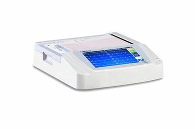

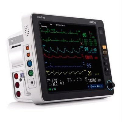

Thank you for your quick response. I contact altium for designing section..plz take a minute for this case and advice me on selected H.W for a custom board that needs to be compatible with two applications sharing the same hardware .By the way, if I get a proper idea about this development pathway, I think it's best to avoid unnecessary complications.so, here is my end product needs
  1. ECG MACHINE- I2C touch display: Our end product features a TFT LCD 10.3-inch LVDS display at 1980x720 resolution, 24-bit color depth, and 200dpi, which is a customized bar-type display.
  2. PATIENT MONITOR- normal TFT 12.3' 1280*780 lvds display with i2c.
During initial development, I chose the STM32MP157 MPU for the patient monitor, but now I require separate hardware and display for ECG pulse display at 1980x720 resolution. I'm considering GUI frameworks like Embedded Wizard or TouchGFX. Can the STM32MP157 manage both applications without Linux, or would the H745 dual-core MCU be better suited for these tasks?
Thank you in advance for your assistance.
1920x720 surely? Pretty much going to be at the edge of the envelope for 2-lane bandwidth there. Would definitely recommend building a proof-of-concept from available parts/boards to confirm it's viable, with no tearing.

Hi, thank you for your kind reply. Currently, I have tested using the F769-DISC0 with its built-in DSI display for vital signs, and I have successfully done it with and without touch GFX as well. At the moment, it seems manageable for me. However, to transition this into a real product, I would like to seek your advice. If you were in my position, could you suggest a suitable hardware chip for our application? For instance, if we use a 10-inch display with dimensions of 250mm x 105mm and a lower resolution of 1280 x 780 if I got customize from vendor,now , would any MCU be capable of handling it? If you recommend for my application, particularly for an ECG machine, can the MP15xx be skipped if Linux is not necessary, and if all tasks can be accomplished with FreeRTOS and TouchGFX? Is that correct? In STM, which hardware would be suitable for our product, where memory constraints and real-time OS are not major concerns, also for display framebuffer for 2 channel lvds you recommend?"
Still I hold order for display and didn't do custom board...so, guide me in proper direction. I will be so grateful.. thank you ...our ideal end product
