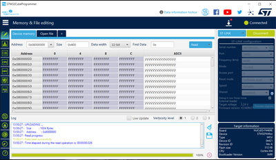

I'm having trouble updating the STLINK on my Nucleo F446-RE board. CubeProgrammer allows me to read the microcontroller's memory without any problem, but when I try to update the STLINK firmware, the following happens:

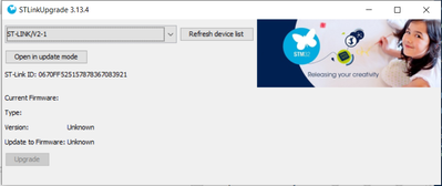

It is detected (although it does not provide information about the current firmware or version):

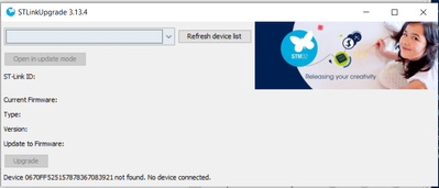

However, when I click on "Open in update mode", it becomes "not connected" and I cannot update the firmware. This is a problem because CubeIDE requires me to update the STLINK in order to debug. What could be failing? What am I doing wrong?ā

Just in case it helps someone: I solved the problem by installing a dedicated USB driver (STSW-LINK009) and changing the USB cable.
More info in the RN0093 release note: "Firmware upgrade for ST-LINK, ST-LINK/V2, ST-LINK/V2-1 and STLINKāV3 boards"

In CubeIDE options disable checking st-link version. This should stop it from nagging you.
If you want to update: try again on a pristine PC - no 3rd party or corporate software, especially "endpoint security". Use a good USB cable.
