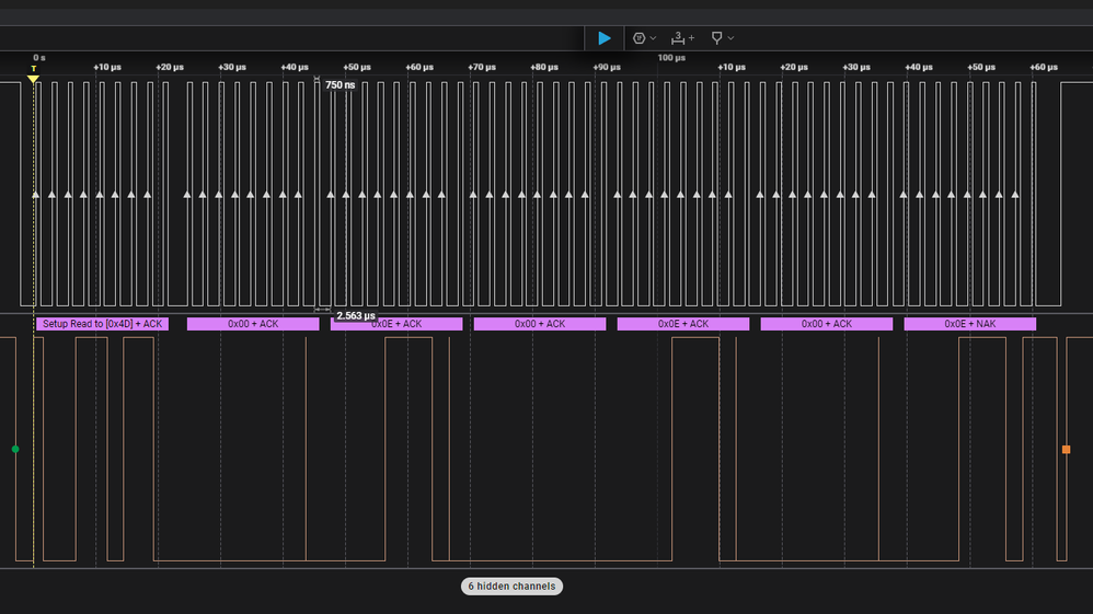

2024-10-21 5:55 AM - edited 2024-10-21 7:01 AM
Hi @Ghofrane GSOURI
I've attached a simplified single transfer with just 7 bytes, so we can see it better - 1 byte is the MCP3221 address (its correct) and we have 3 pairs of 2 bytes that are 0x000E (that is also the correct value).
What i need is a way to not send NAK and the Stop condition after the last byte, because that terminates the transfer.
EDIT: I tried edition the I2C_DMAXferCplt function, by removing everything that disabled interrupts or changed the state. This removed the stop condition, but not the NAK and it ended the transfer.
