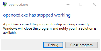

I tried to run OpenOCD on a virtual machine with Windows Server 2016. We using the version 1.3.0 of the STM32CubeIDE.
When I launch the OpenOCD the program crahses with the error message:
OpenOCD is launched via this command:
CALL %PATH_STLink-OPENOCD%\openocd.exe -f %CD%\ReactionWheelTestFramework_Develop_Master.cfg -s %PATH_SUPPORTFILES% -d4

‎2022-03-09 12:22 AM
STM32CubeIde v1.3.0 is quite old.
v1.9.0 is out, update and tell us if you still have the issue.
Maybe linked to the STLink USB drivers ?
Did you install them ?
You have admin rights ?
Can the STLink debug works in STM32CubeIde (using Openocd debug server) ?
Rgds,
Laurent
‎2022-03-09 12:34 AM
It looks like this known problem of OpenOCD with the new libusb 1.0.25
https://sourceforge.net/p/openocd/tickets/308/
https://sourceforge.net/p/openocd/tickets/336/
It has been fixed in upstream OpenOCD
http://review.openocd.org/6331/
but there is still no official OpenOCD release that includes it.
‎2022-03-09 12:36 AM
thank you for your help. :)
I have tried with version 1.8.0, there i have the same problem.
Yes, the STLink USB drivers are installed. I also have admin rights. The Nucleo board is connected via an UTN-Server (SEH myUTN 250).
It works fineOn my local PC :\
I also tried to launch the Openocd debug server via the STM32CubeIDE with version 1.3.0 and 1.8.0.
‎2022-03-09 1:08 AM
I insert the libusb 1.0.25. Now I didn't get the error message of "openoced.exe has stopped working".
But the debug output gives me now an error:

‎2022-03-10 1:45 AM
Hi there,
thank you for your support.
I have solved this issure by updating the UTN-Server. Now i runs fine :)
Best regards
