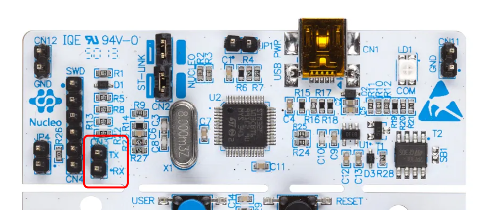

Hi, I'm a student quite new with STM, I am using a nucleo F072RB and I have been unable to print anything onto putty for a few weeks, it was working fine before summer break but not anymore (I haven't used my nucleo during that time), I am using the same baud rate and same port com as before, I tried to run my older projects that use putty and same result, nothing appears. I have no idea what to do to try to solve it, please help. Thanks.

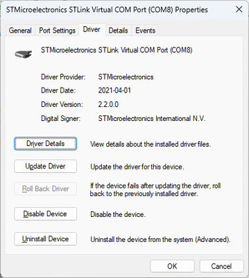

@dyMath6 wrote:
 I'm not sure what you mean by "expected COMx number",
I mean does the COMx number you're using in your terminal match the COMx number shown for the board in Device Manager?
@dyMath6 wrote:
I'm left with the port drivers though I'm not sure where to look for that
In device manager double click or right click and select properties. The go to the driver tab.

Have you tried the oscilloscope test yet to see if there is any activity?
Your NUCLEO-F072RB board has a jumper - CN3 - on the ST-Link section where you can probe:

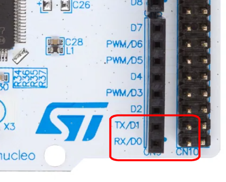

Also probe on the Arduino CN9 header:
(and/or CN10).
Do you see activity on TX when the STM32 is transmitting ?
Do you see activity on RX when the terminal is transmitting ?
PS:
If you disable the TX & RX pins on the STM32F072 Target, you can put a jumper on CN3 and do a loop-back test from the terminal.

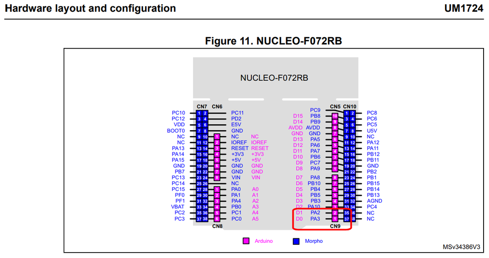

@Andrew Neil wrote:
(and/or CN10)
Note that the Arduino D1 and D2 pins (CN9.2 & CN9.1) are connected to CN10 pins 35 & 37:
https://www.st.com/resource/en/user_manual/um1724-stm32-nucleo64-boards-mb1136-stmicroelectronics.pdf#page=30
via: https://www.st.com/en/evaluation-tools/nucleo-f072rb.html#documentation
