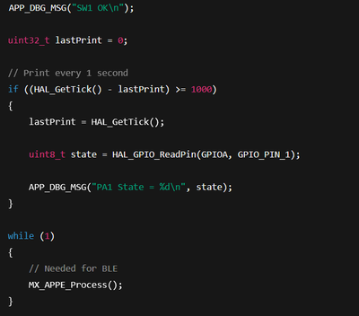

Here is the code snippet:
APP_DBG_MSG("SW1 OK\n");
uint32_t lastPrint = 0; // Print every 1 second
if ((HAL_GetTick() - lastPrint) >= 1000)
  lastPrint = HAL_GetTick();
  uint8_t state = HAL_GPIO_ReadPin(GPIOA, GPIO_PIN_1);
  APP_DBG_MSG("PA1 State = %d\n", state);
while (1) { // Needed for BLE MX_APPE_Process(); }

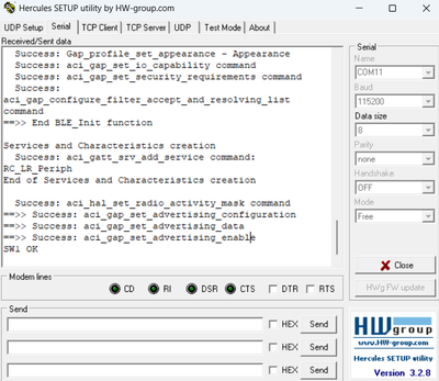

The output I get is:
aci_gap_configure_filter_accept_and_resolving_list command
==>> End BLE_Init function
Services and Characteristics creation
Success: aci_gatt_srv_add_service command:
RC_LR_Periph
End of Services and Characteristics creation
Success: aci_hal_set_radio_activity_mask command
==>> Success: aci_gap_set_advertising_configuration
==>> Success: aci_gap_set_advertising_data
==>> Success: aci_gap_set_advertising_enable
SW1 OK
After that, I never see “PA1 State = …”.
No further serial output.

Saket_Om
Hello @pradeepaan
The code does not enter the if condition, which is why the pin state is not printed.

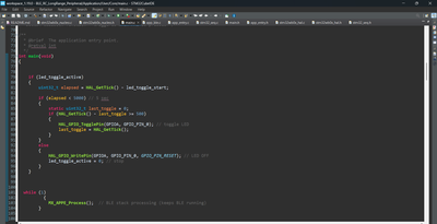

Hello @Saket_Om
Thanks for the response.
I understand why the if() is not entering, but my question is:
How can I run this function (LED toggle logic) without using while() or if() inside the main loop?
I want the LED toggle to work automatically when the button callback sets led_toggle_active = 1, but the BLE example uses:
Since everything must run inside the BLE scheduler, I am not sure what is the correct method to schedule or run my LED toggle function without adding blocking code or polling inside the while(1) loop.
Should this be implemented using:
  • UTIL_SEQ_SetTask() or
  • a timer callback
  • or some other recommended method?
Please advise on the proper way to execute such logic in STM32WB without adding if() checks inside the main loop.
