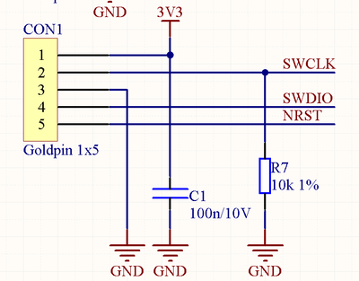

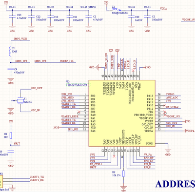

I am developing the Prototype with STM32WL microcontroller to which I provide a schematic snippet below:
+ SWD 1x5 goldpin connector:
If the image quality doesn't let you inspect the nets, I will provide a better image later.
The 3V3 voltage is stable, SMPS delivers beautiful 1,55V and I was able to connect to the uC and program it with ST-Link V2.

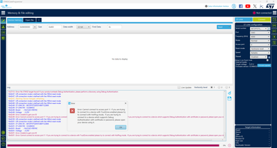

Here's my problem: when I tried to program my Prototype with Nucleo's ST-Link (N-ST-Link) I was unable to connect to device. N-ST-Link has SW version of V2J46M32 and I use STM32CubeProgrammer Version 2.20.0 I connected VDD, GND, SWCLK, SWDIO and NRST signals between boards, clicked "Connect" and received following message:
During debugging I checked the voltage of NRST pin. When N-ST-Link's NRST pin is disconnected the Prototype's NRST voltage is equal to 3.3V. When I connect both NRSTs signals, the voltage drops to 1,55V. When Prototype's NRST pin voltage drops for the first time the uC is still running (debugging diode is blinking), but when I hit "Connect" I receive the error message shown above and uC's program halts.
My guess is that the 1,5V on NRST is a result of a voltage divider between Prototype's internal pull-up resistor and N-STLink's possible pull-down resistor. It is just an assumption as I have not noticed any pull-down on N-STLink schematic, so the only possible resistor for a voltage divider may come from internal GPIO structure. Clicking "Connect" in STM32CubeProgrammers drives NRST to 0V and then it comes back to 1,5V and uC stays stuck, as it has not reached a valid "1" state voltage.

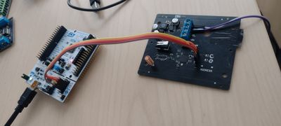

Photos of your setup would help.

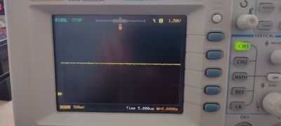

If NRST is going low, possibly you are exceeding the current limit on some regulator, causing a brown-out condition. A measurement of 1.5 V on a multimeter could be a sign the microcontroller is repeatedly resetting rather than a static signal of 1.5 V. I don't think this is a resistor bridge issue. NRST is driven as an open-drain.

@Andrew Neil Here I provide the photo of a setup:
 The "VDD_Target" pin is disconnected as it was proven in this thread that Nucleo supplies its own supply to "VDD_TARGET". The ST-Link V2 is hidden as it is not a subject to the problem.
@TDK If I were exceeding regulator ratings there would be a lot of heat coming from at least one of the ICs on N-ST-Link or my Prototype, wouldn't it? All is cool, PC still detects Nucleo as USB device and my board draws stable current of 5 mA (mind the other PCB circuitry) and regulators produce stable voltages. I haven't checked whether STM32WL is resetting itself, I have to prepare a code for that, but regular blinking of a 1s diode timer somehow tells me that the uC is not resetting itself. There are no voltage fluctuations on NRST pin as well. In order to suppport my claim I provide an oscillogram of NRST:
   I switched between 1 us/div to 50 ms/div and it all looked the same as pictured above.

I see no ground link between the two boards?
Your Rigol scope should have a USB socket for getting screenshots - that will give far better results that photos!

@Andrew Neil The yellow wire connects GND of N-ST-Link and GND on my Prototype.
I wanted to get the image as soon as possible, that's why I used my camera. Next time I will use USB drive.
PS. Yes, I have verified good 3,3V with the same oscilloscope. the ripple amplitude is comparable to noise of oscilloscope.
