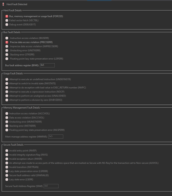

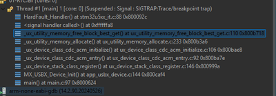

Yes, I've tried attaching a debugger, and that's what I'm getting:

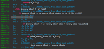

The Hard Fault occurs in ux_utility_memory_free_block_best_get.c in _ux_utility_memory_free_block_best_get function (line 110) while getting a value from memory_block -> ux_memory_block_status. According to debugger, memory_block is 0x1. I've also got the PC address: 0x800bae8, which shows this disassembly
And the hard fault reason is:

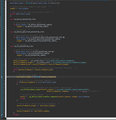

UPD. I've also tried updating Firmware Package Version to STM32Cube FW_U5 V1.8.0. Now, I'm not getting the hard fault during MX_USBX_Device_Init. However, now I'm stuck in an endless loop in ux_device_stack_descriptor_send.c
