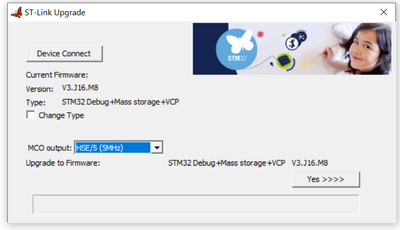

I am using Nucleo-144 boards in my project where I have changed the clock source for STLINK IC to external crystal using STLINK firmware upgrade tool. Before it was HSI/2 =8MHz. Now I am trying to revert the configuration back to 8MHz but I am not able to detect the Nucleo board now with 8 MHz. Is this known issue?
I tried configuring it back to 5MHz using tool below and it works fine , detects all the time in MATLAB. But not with 8MHz (HSI/2).
How to revert back the configuration and make the board detectable?

But it was working fine with 8MHz prior change to 5MHz (HSE/5).
As it was reverted back to "HSI/2= 8MHz" with STLINK firmware upgrade tool and you are measuring 8MHz so this is not a board issue. Check your clock config in the Matlab/Simulink.

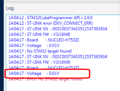

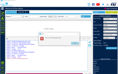

I have tried connecting same nucleo 144 board to ST32cube programmer after setting freq to8MHz but i am getting below error. So irrespective of MATLAB it is not detecting in any other tool.
You've marked this as solved, but it seems not solved?
See this for how to un-mark a solution.
Your log shows that there is no power on the Target:
@Andrew Neil unmarked the solution.
@DJ_IND  as pointed out by @Andrew Neil , the VDD voltage detected by STLINK is 0V. as if the MCU is not powered. Did you remove any jumper from the board? the IDD jumper for example?
