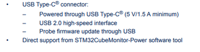

The STLINK-V3PWR differtne from the other STLINK's needs a lot of current from the USB port:
So should not be connected to an USB type-A port (normaly max. 500mA).
Programming the flash will increase the current consume.

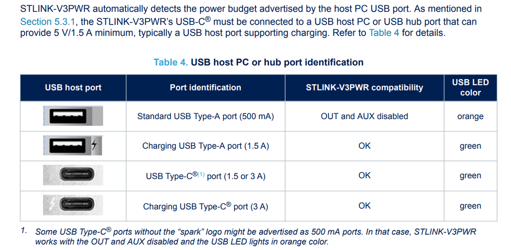

But i think, its more : it can use a lot of power, because giving power to target also;
but without target, just for upgrade, its still same cpu as other V3 , that update firmware on USB-A without any problem. (I did it also, never a problem, with V3 miniE or xx-mods .)
The STLINK-V3PWR, apart from the "standard" debugger part (build with a STM32H745, the most powerful and consequently most current consuming MCU used in the different STLINK's) has all the circuitry used for the power delivery and measurement. For example for me it was not possible to connect the STLINK-V3PWR to the same USB port where an STLINK-V3SET with additional Isolation board (STLINK-ISOL) was working ok.
Ok, i see...
+ from manual, it should check , if connected usb port is ok...or not :
