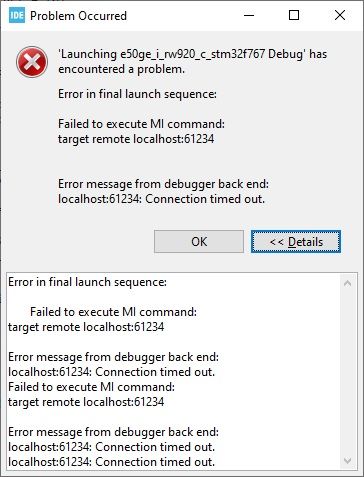

This is now the third Nucleo board that has been "bricked" by a forced ST-Link V2-1 update. I can no longer program the board. Windows 10/11 sees the board as a USB thumb drive (this has always worked) but from within the STM32CubeIDE it will not program the board. It says "waiting on debugger connection" but hits a time out.

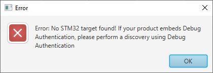

So then using the STM32CubeProgrammer I get the error message "Error: No STM32 target found"
Like I have said this has happened to 3 other Nucleo boards I have and I cannot program them anymore. I am tired of the IDE forcing an update to ST-Link and the update bricks my board making it useless. I tried saying "No" when the IDE asks me to upgrade the ST-Link firmware. But then it says it cannot program the board with out first upgrading the ST-Link firmware. So then I update the firmware and cannot program the boards anymore.

I do not know if this will solve the issue for anyone else, but I was able to recover my Nucleo boards.
On another computer with the latest versions of STM32CubeIDE and STM32CubeProgrammer I was able to reprogram the Nucleo boards I was having an issue with. I was able to down grade to the firmware version that was working using the STM32CubeProgrammer and tested programming some firmware to the boards. Then I used CubeProgrammer to update the ST-Link firmware to the latest version and test it - worked.
Went back to the original computer where it first "bricked" my boards. Tried programming them from CubeIDE and CubeProgrammer and they did not work. I received the same errors as I originally posted. I updated CubeIDE and CubeProgrammer and still received the same errors.
I had to completely uninstall CubeIDE and CubeProgrammer, use a cleaning program to remove all traces, then reinstall the latest versions then I was finally able to use the original computer that "bricked" my boards.
