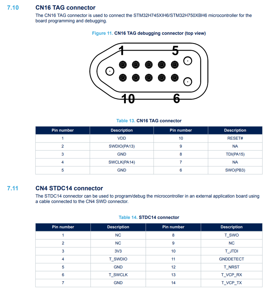

my board is unable to detect when I flashed it after that led is glow is not glowing plz help me
HPunm.1
earlier using st-link for debugging that time it was not showing anything on the display and the blacklight was also not flowing then using stlink utility flashed the board, now not is been detected so please me regarding this

Ok so you've connected to the STM32F723 implementing the ST-LINK/V3, that you've probably erased at this point. So no longer going to function, nor connect to the PC or the STM32H745
@Sara BEN HADJ YAHYA​ @Amel NASRI​ is there a means/method to recover the ST-LINK/V3 firmware, like a boot loader, or other image?

Seems ST make big mistake and dont write into pdf warning Dont solder con into ... but feature reprogram too F72x on STLink part is cool if is descripted.
External programming for you now only usable on
0693W00000WLFaiQAH.pngand call support for bin file STLink repair.

Well 3-days in, and I'm not clear what you did to get it in this state. But using ST-LINK Utilities on an H7 and ST-LINK/V3 is probably one of the issues. The tool has be deprecated for Years.
Problem is you don't appear to have been cautious, and "tried everything" to the point now that the debugger has been erased, and that's quite a challenge..
I'm not sure there's an official recovery path from here. ST don't officially release the binary for the ST-LINK/V3 although you might find a copy online somewhere. It might be possible to find a CMSIS-DAP or Bla-ck Mag-ic probe firmware that works on it.
