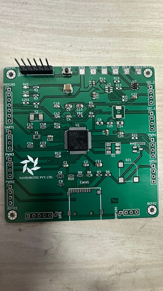

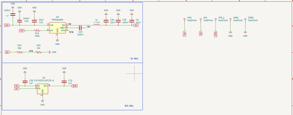

I designed a custom PCB using the STM32F401RE (LQFP64), but I cannot connect to the MCU through SWD. I am using an ST-Link probe and the st-probe command-line tool.
When I run the probe command, the ST-Link probe itself is detected, but the target MCU is not properly identified. The tool reports the flash size as 0x00.
MCU: STM32F401RE
Debugger: ST-Link probe
Tool: st-probe
Observed behavior:
  • ST-Link probe is detected correctly.
  • The MCU is not detected.
  • Flash size reported as 0x00.
Power measurements:
  • VDD = 3.3 V
  • VDDA = 3.3 V (through ferrite bead BLM18AG601SN1D)
  • VCAP ≈ 1.2 V (2.2 µF capacitor connected directly, ~8 mm trace, no vias)
  • NRST = 3.3 V
  • Total board current ≈ 18 mA (two LEDs also present)
The MCU does not heat up, and current consumption appears normal.

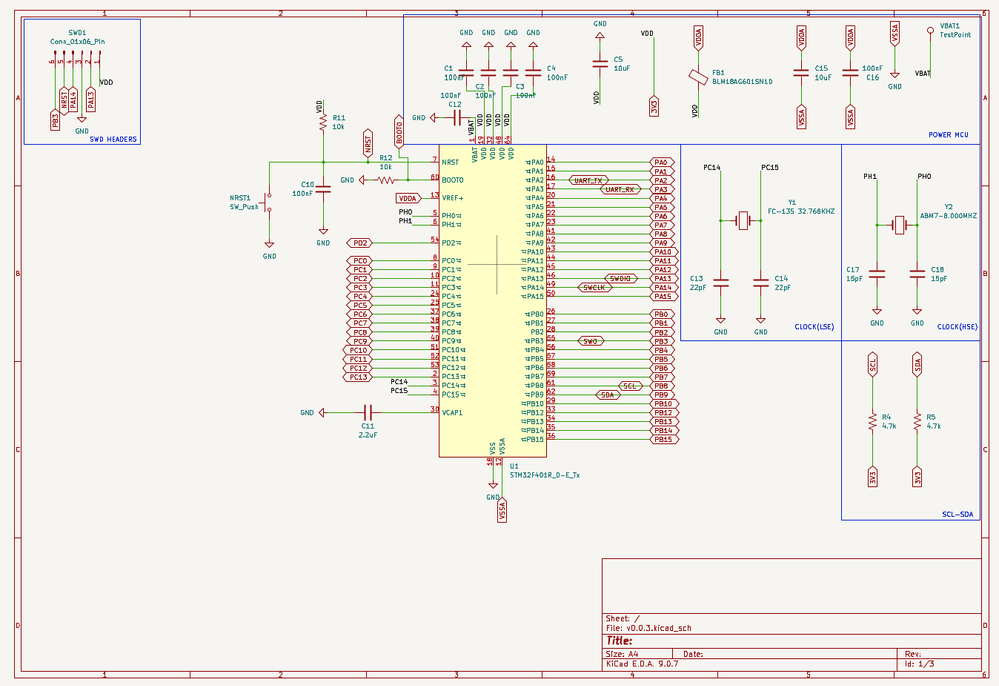

Power architecture:
12 V input → buck converter → 5 V → LDO → 3.3 V (MCU supply)
Analog supply filtering:
VDD → ferrite bead → VDDA
Decoupling capacitors are placed near the MCU.
Debug connections:
SWDIO → PA13
SWCLK → PA14
NRST connected to the debugger
VREF connected to 3.3 V
BOOT0 pulled down with 10 kΩ
Minimal hardware configuration:
For initial bring-up I have connected only the required components for the MCU to boot:
  • Power supply and decoupling capacitors
  • Boot configuration resistors
  • VCAP capacitor
  • SWD debugging header
No external peripherals are connected to the MCU pins.
There is no external clock connected:
  • No HSE crystal
  • No LSE crystal
The MCU should therefore start using the internal HSI oscillator.
Troubleshooting attempted:
  • Verified all voltages with a multimeter
  • Checked board current (~18 mA)
  • Tried lowering SWD frequency
  • Tried connecting under reset
  • PCB photos
  • Schematic photos
Could someone help identify possible hardware issues that might prevent the MCU from being detected over SWD?
Thank you.

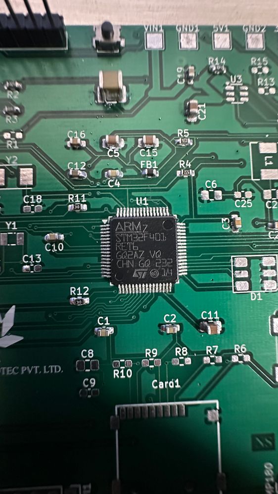

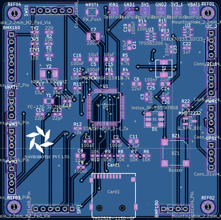

The orientation is incorrect. Pin 1 on the chip is here:
This does not match your pin 1 marking on the silkscreen.

If VCAP has no voltage, the chip isn't getting power.
Schematic looks okay. Maybe the part isn't soldered correctly. Show a large in focus picture of the actual board. Maybe orientation is wrong.

Maybe not issue related but why VBAT is not connected to VDD (if you are not using a battery)?

I checked the board again and verified a few things.
All VDD pins measure 3.3 V, and VDDA is also at 3.3 V.
NRST is at 3.3 V as well.
I also checked **continuity between the MCU pins and the corresponding capacitors **, and the connections appear correct. The SWD signals and power pins all show proper continuity to the header and supply rails.
Regarding the earlier VCAP measurement, I likely made an error during the first measurement. After checking again carefully, the VCAP pin is currently reading 0 V.
To rule out soldering or orientation issues, I am attaching clear photos of the actual PCB, including the MCU area and the SWD header, so that the solder joints and orientation can be inspected.
Thank you for the suggestion.
Thank you for the response.
you are correct that it should be connected to VDD if no battery is used. That was an oversight in the original design. I have already corrected it on the board by shorting VBAT and VDD.
It worked!!! :party_popper:
Thank you so much for pointing that out. The issue was indeed the orientation of the MCU. After correcting the orientation according to the proper Pin 1 location, the chip is now detected correctly.
You probably just saved me from having to spin another PCB revision, so I really appreciate the help.
Thanks again!
You should mark the solution that helped you as the solution, not your own reply. It helps others find the correct solution.
