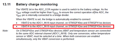

You can do it with ADC CHANNEL18:
See RM0090:

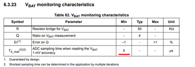

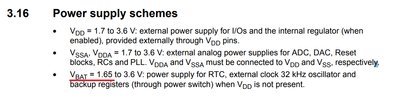

Other information that you need to take care about when you need to monitor your battery with ADC:
From the datasheet:
