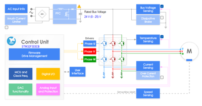

I am working with the following tool versions:
  • MC Workbench: v5.4.8
  • STM32 Firmware Package: v1.11.3
  • STM32CubeMX: v5.6.1
Since I don’t have the Bull Running C1700KV motor, I’m using a 900KV motor with a 6S battery. I’ve already run the profiler, obtained the motor results, and entered those parameters into MCSDK.
My question is: Which additional parameters should I adjust to generate reliable firmware for this setup?

What do you mean by additional parameters? The latest version of MCSDK is 6.4.
MCSDK 6.4 is not working for STEVAL-ESC001V1
Firmware drive Management parameters
Hello @aj8791,
STEVAL-ESC001V1 and Bull Running C1700KV motor use case operates in 6-step mode with MCSDK version 6.4.1.
