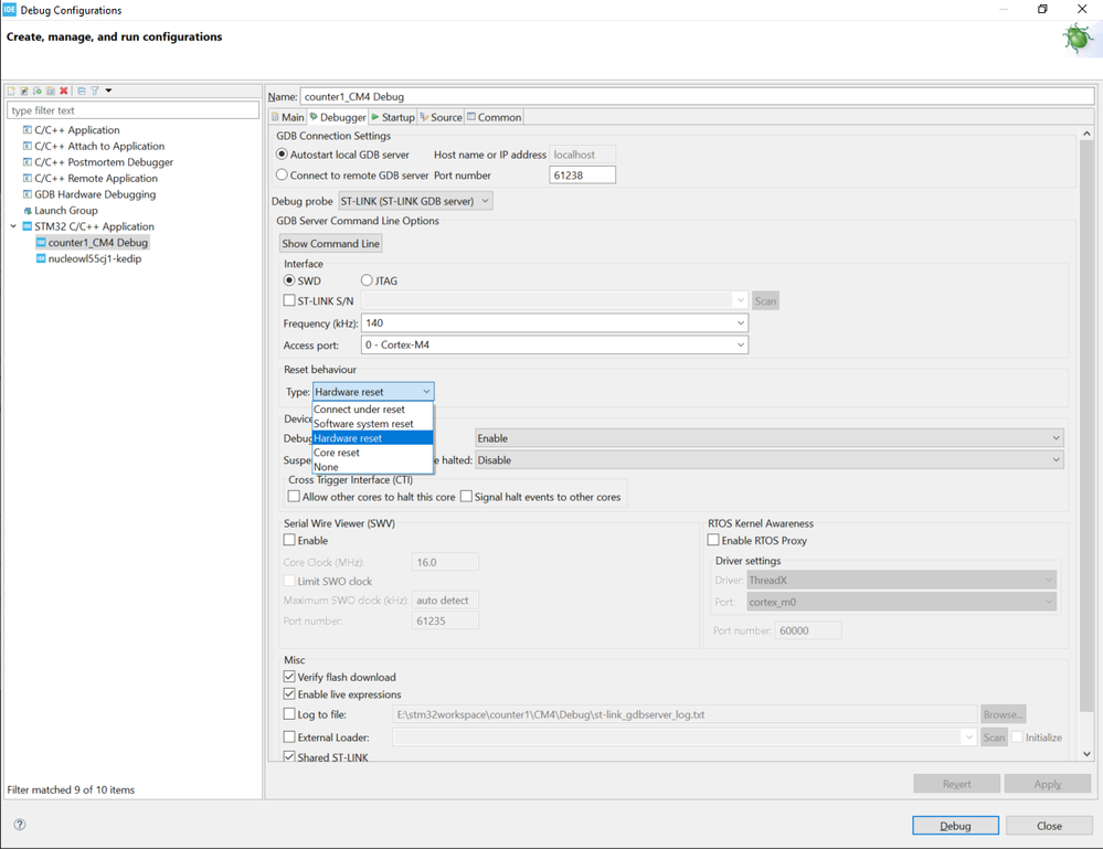

Im trying to flash first program into STM32U575ZIT. For some reason I m getting the next error: stm32 failed to start GDB server error in initializing st-link device REASON:no device found . I updated the ST-LINK and still not working.
tried to update the ST-LINK with the cubeIDE after that with the ST-LINK TOOL and at the end I tried to install the latest driver with device manager .
the STM32U575ZIT is pack fresh .
(nucleo)

I'm having the same problem with the (ST-LINK GDB server) connection, when I switch to 'ST-LINK (OpenOCD)' I can debug the application.
When I use the (ST-LINK GDB server) I get the following message:

Target unknown error 32
Error in initializing ST-LINK device.
Reason: Unknown. Please check power and cabling to target.
Version CubeIDE : 1.8
GDBserver version: actually don't know
even if some configuration work it still succeed only after 2-3 tries if work at all .

In my case, I get it to run by setting --> menu Run.Debug Configurations. Debugger:
1) connect to remote GDB Server Port Number change to not 61234 --> 61238, (while still chose Autostart local GDB server, Connect to remote GDB Server is not chosen, just change the number
2) Reset Behaviour: choose Hadware reset
Then it runs smoothly every time.. :) :), I really don't know what is the best/correct answer, just sharing my experience...
