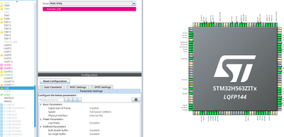

Hi, I tried to configure the USB Host for a project, but it’s difficult to configure, and I am not finding any online support available for the STM32H5 series controller.
My requirement: I configured PB4 as an output, which is connected to a green LED. Whenever I plug the USB into my controller, the green light turns on, and whenever I remove the USB from the controller, the green light turns off.
I’ve tried some methods, but they are not working. Can anyone please help me?

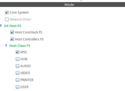

you can find an USB HOST example for STM32H5 in the Projects\STM32H573I-DK\Applications\USBX\Ux_Host_HID_CDC_ACM folder of the software package availbable here:
STM32H5 SW package
Your project seems to make use of an old package v1.1.1 when v1.3.0 is available.

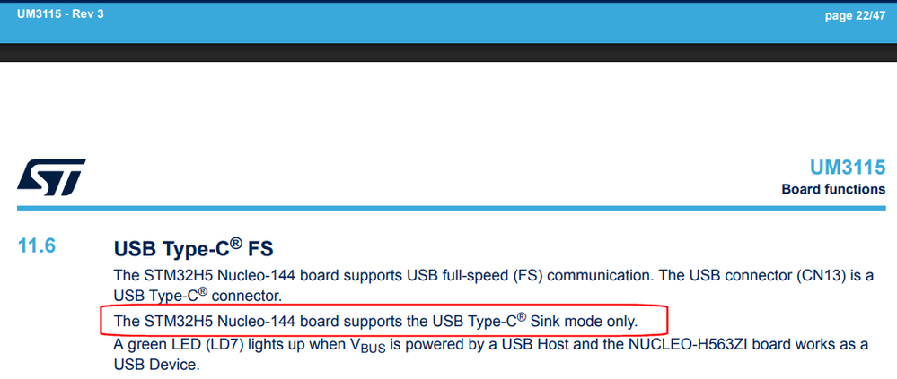

Why is host mode not supported on the STM32H563ZIT6 nucleo if it is supported by the chip?

It is really unfortunate that the Nucleo Board STM32H563ZI does NOT support the user USB plug CN13 to act as USB Host.
So there is no way using this board to test how an STM32H5xx embedded device would work with USB sticks for example.
https://www.st.com/resource/en/user_manual/um3115-stm32h5-nucleo144-board-mb1404-stmicroelectronics.pdf#page=23
via: https://www.st.com/en/evaluation-tools/nucleo-h563zi.html#documentation
I guess that limits it to Device only?

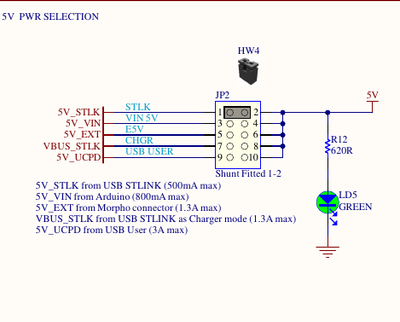

I used the user-usb as host...just you cannot expect its working as full USB-C !
To connect an usb-stick it will work, just use an adapter usb-C -> usb-A (as i did ).
And to get the needed 5V ...just put some jumpers on the block:
i have 3 jumpers on : 1-2 , 7-8 , 9-10 ; so you get vbus to the user usb , from st-link/debug usb.
Was this, with Azure usbx:
